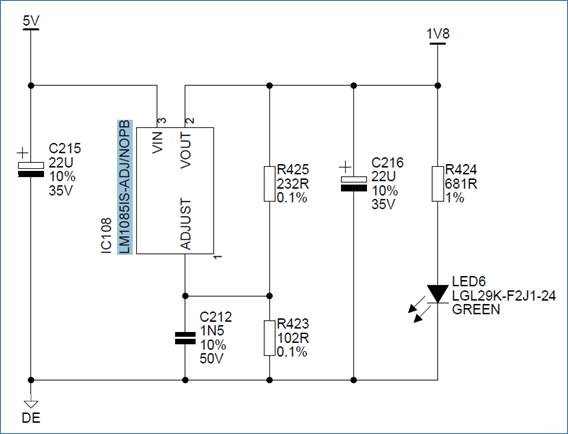

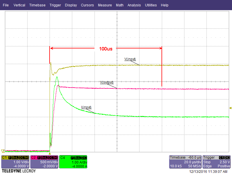

Dear team,
My customer is currently using TI part LM1085IS-ADJ/NOPB in one of their designs and are trying to route cause an issue.
They need help about the rise time for this device.
Their setup powers the part from 5V and it is configured for a 1V8 output – if we consider t0 to be application of steady 5V then at what time can the output be considered steady?
Do you have any graphs you can share with me?
Thanks in advance for your help.
