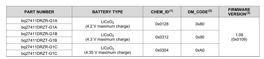

I am trying to perform a successful learning cycle with the following components:
1) GDK board
2) battery pack with a bq27411-g1 gas gauge and Li-Ion 1800mAh battery (UltraLife UBBP01)
So far, I have been able to perform the following learning cycle steps with some success :
1) Program the gas gauge with the .gg.csv file and issue a SOFT_RESET command to disable the resistance update. [RUS_DIS] bit of ControlStatus() register is set.
3) Discharge the battery to empty
4) Relax for 5 hours. Both [VOK] and [RUS_DIS] bits in the ControlStatus() register are clear and OCV measurement is taken at 3200mV.
5) Charge the battery to full at a C/2 charge rate. At the start of the charge, [VOK] bit in the ControlStatus() register is set. At the end of the charge the [FC] bit in the Flags register is set.
6) Relax for 2 hours. The [VOK] bit in the ControlStatus() register is clear and OCV measurement is taken at 4160mV. The [QMAX_UP] bit in the ControlStatus() is set, but Update Status in Data Memory does not change to 0x01, it is still set to 0x00
It is the second time I got to this point with Update Status staying to 0x00. I will try to finish the learning cycle with the discharge but I doubt it will succeeded. I have attached the log of the registers (lc_charge.log) and the data memory (File027.gg.csv) at the end of the process.
Any help on this issue will be appreciated.lc_charge.txt

  • Although the Update Status did not change to 0x01 during the charge part of the learning cycle, I decided to go on with the discharge. So starting from step 6) above, the learning process went on with :
    7) Discharge battery to empty. The discharge current is set to C/20 (200mA). During the discharge, [RES_UP] bit is set to true, but at the same time [RUS_DIS] is also set to true. So the resistance profile starts to update, but for some reason, the gas gauge ended it.
    8) Relax for 5 hours. The [VOK] bit is clear. Both [QMAX_UP] and [RES_UP] bits are set. Update Status is still 0x00 and only the very first index of the resistance profile R_a 0 has been updated in Data Memory.
    According to the document slua597 - Achieving The Successful Learning Cycle:
    "During discharge, the Resistance Table may update for a while, and then stop. When this happens, [RUS_DIS] is set. This indicates that the Chemitry ID choice is incorrect. This means that the gauge has measured a resistance value that just doesn't make sense (i.e. is negative). A chemitry cycling is need to identify the correct chemistry profile."
    The only problem I have with that statement is that the bq27411-g1 gas gauge HAS A PRE-PROGRAMMED chemistry profile for Li-Ion battery which, by the way, the battery Ultralife UBBP01, that was used for the learning cycle, is. So, I assume that this gauge is useless with this battery and I have to select another gauge (or another battery?).
    Is the bq27411-g1 gas gauge suppose to work with Li-Ion batteries (or as I found by reading MOST of the Li-Ion batteries) ?
    In an attempt to understand something for this. I decided to use the GPC chemistry identifier with the data I have obtained from the learning cycle. I was puzzled with the report that was sent back to me.
    "Warning: Deviation is above recommended level. New chem ID needs to be released for this cell. Please contact your TI representative to send the cell to Dallas for characterization"
    and later in the document
    "Device / Family #1
    Generic Chem ID Device/ Voltage/ Chemistry max DOD error, %
    3142 bq27421-G1D: 4.4V LiCoO2 8.03
    354 bq27411-G1C: 4.35V LiCoO2 9.27
    128 bq27421-G1A: 4.2V LiCoO2 11.98
    312 bq27421-G1B: 4.3V LiCoO2 21.99
    Best generic ID 3142
    Warning: Deviation for best generic ID is above recommended level for this device / family. Consider using another device, flash based gauge or RAM programming of custom ID."
    So if I understand this correctly I have to use either another battery (which one will work I have no clue) or another gas gauge.
    Is this why the learning cycle with this gas gauge/battery combination failed?
    Could somebody help me solve this problem ?
    I have work on this for almost 2 weeks now, without success.
    P.S. I have attached to this reply the log of the standard commands (lc_charge.txt) for the whole duration of the learning cycle, the GG file of the gauge at the end of the process (gg.txt) and the chemical report received from GPC engine (GPC_report.txt).3731.lc_charge.txt

  • Hi Hugues,
    Sorry for the late response.
    1. Actually as you said, bq27411 could support specific chemID battery,
    If the chemID of your battery is not belong to above picture, maybe you need to choose other gauges.
    2. You should do chemID first with your gauge. I think you have got the method.
    3. For learning cycle, you should not only focus on update status. Please auto export your gg.file to check whether the Qmax and Ra table has been updated after the self-learning cycle. Meantime, use below files to calculate the accuracy of SOC to judge whether the self-learning cycle is successful or not.
