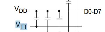

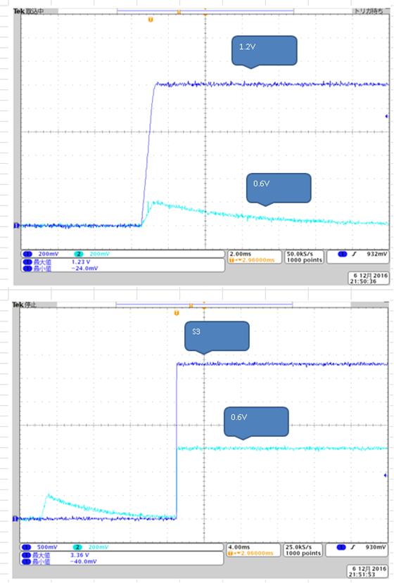

・About start up VDD and Vtt, Vtt occurring leak.
 Wave form is attached below,
・Cause is capacitor's leak from memory module.
・I think that measure is below two idea;
 ①VDD start up time become slowly.
 ②Same startup sequence for VDD and Vtt
