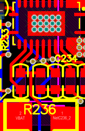

    1) How is your layout for the Kalvin Connections for SRP/SRN? You could have noise coupling in, or if the traces are not matched, the charger will effectively see this as a larger sense resistor than you really have.
    2) Does your battery have any gauging/protection? I am wondering if that is somehow interfering.
    My layout is as shown below
    R236 is the sampling resistor. I think the layout is close to Kalvin Connection pattern. The VBAT and NetC236_2 connections don't have the exactly same length. But I don't think there is such a serious impact, as these are two low-current paths. Is my understanding correct?
    There is no gauging or protection for my battery. For the normal case, in the CC stage the charging current will be a steady value or  vary in the accuracy range, e.g +/-15%, as the charging progresses?
    Thank you!
  • For your last question - the charge current should be a steady value in CC mode. The charger senses the resistance between SRP/SRN, and "expects" a certain sense resistor - usually 10mOhm. At a very high level, it uses Ohm's law to say "I have XXX charge current", and it will feed that signal into a feedback path. This current mode feedback should maintain a very steady current. Once the control loop senses the regulation voltage, it will "give up" regulating charge current. The charger maintains the voltage just like a normal DC-DC converter, and let's the battery/trace impedance determine charge current.
    As far as the layout goes - I think that the mismatch is large enough to cause a difference. You are correct in the fact that little current flows (the pins have some leakage), but the trace impedance will play a large factor. In this case, you don't need much current to cause problems.
  • I will try to modify my layout and see if the problem can be solved. Thank you very much!
