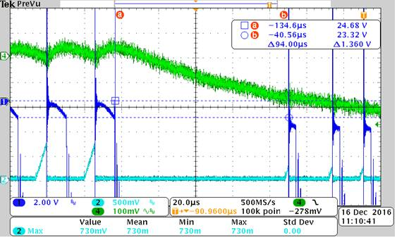

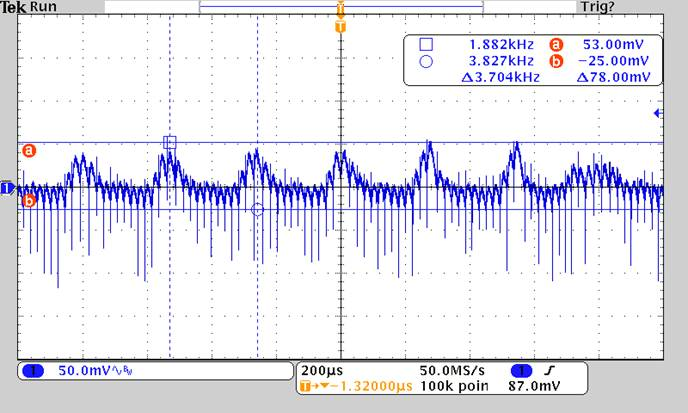

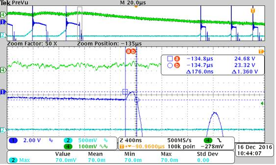

  • Hi Sir,
    1. Check with waveform, VCS occur other spike  when output voltage drop.
    May I know this spike can affect out controller error?
    2. May I know after what long Blacking Time UCC28700 into valley switch ?
    Vin : 115Vac, Vout : 5V / 3.4A
    CH1 : Vaux, CH2 : Vcs, CH4 : Vout
    3. Ripple carrier 3kHz noise is right?
  • Hi Kuo, it looks like some noise is being injected onto the Aux winding which is causing an increase in the winding voltage at the instant that it is sampled to determine the output voltage. This makes the output voltage look too high to the controller and it therefore decreases the switching frequency and peak current.
    Is the flyback operating in a system with other switching stages? Is there something else which could be injecting noise into the aux signal?
