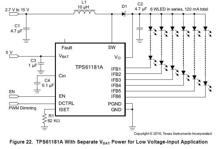

May I know how can implement TPS61181A EVM with WLEDEVM-260 for 3~6 LEDs Series function verify as using Fig.22?
Now the EVM can't workable with the below schematic.
Please kindly provide your suggestion for our verify again.
