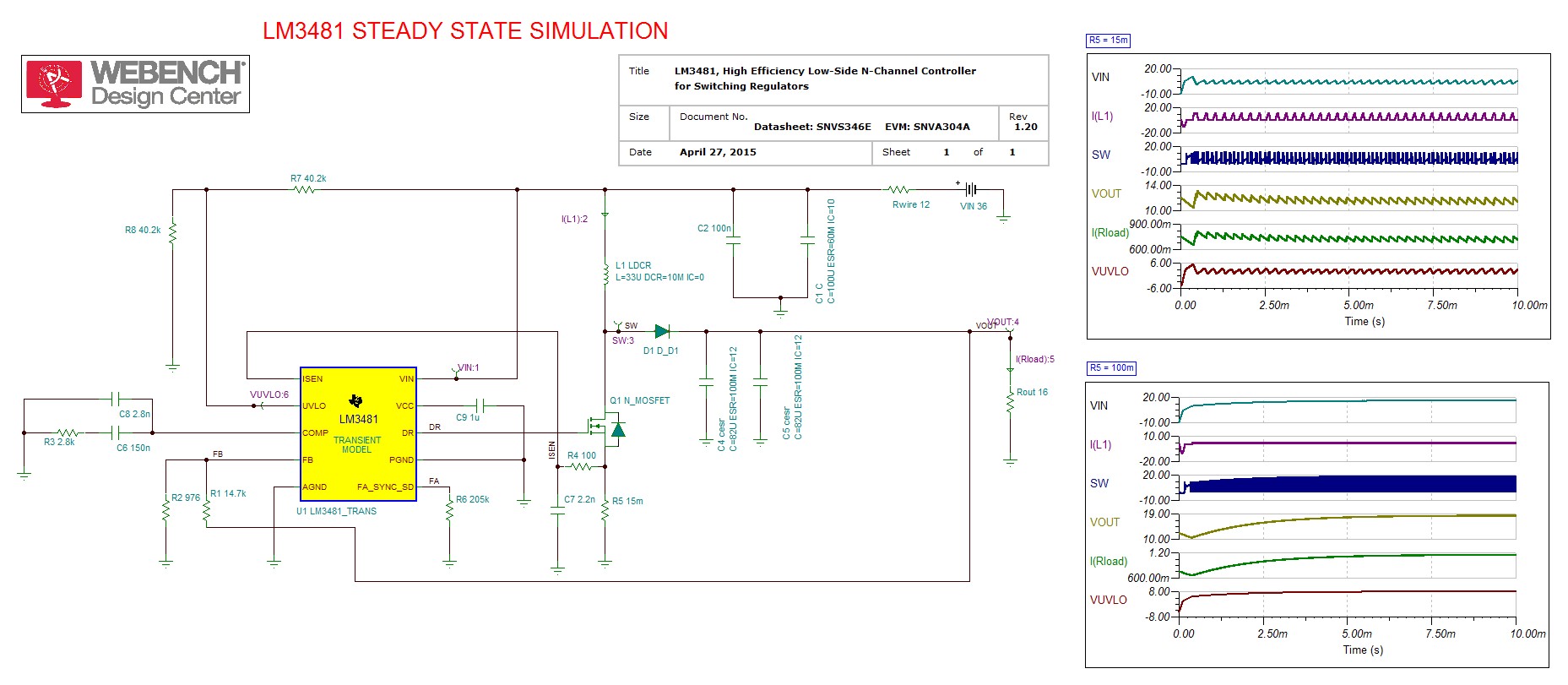

  • Hi Ambreesh,
    Thanks for your suggestion. in order to analyze the situation I've tried to build a TINA simulation from the reference design.
    I'm not sure that I'm modeling the 100m cable correctly as a RWire=12 [Ohm] resistance at the input.
    I've tried 2 parameters current sense resistor (R5), 15m and 100m. As can be seen at the transient outputs attached, with 15m there is a large voltage drop, but with 100m it starts to look stable, although not outputting the full 21[V] output as designed.
    Do you have any further suggestion or maybe the simulation is totally wrong? When we tested it in the real world it worked pretty consistent with the simulation results.
    Ofir
