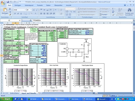

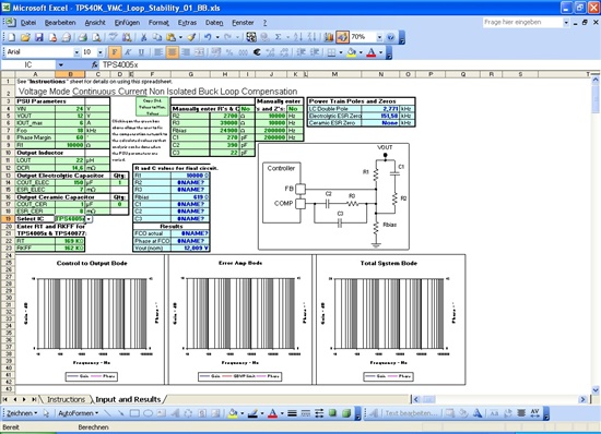

  • Dear Peter,
    1) Regarding Loop Stability tool, please check the attached file. You can see my data. I’m not sure but I think that the Excel file has a bug.

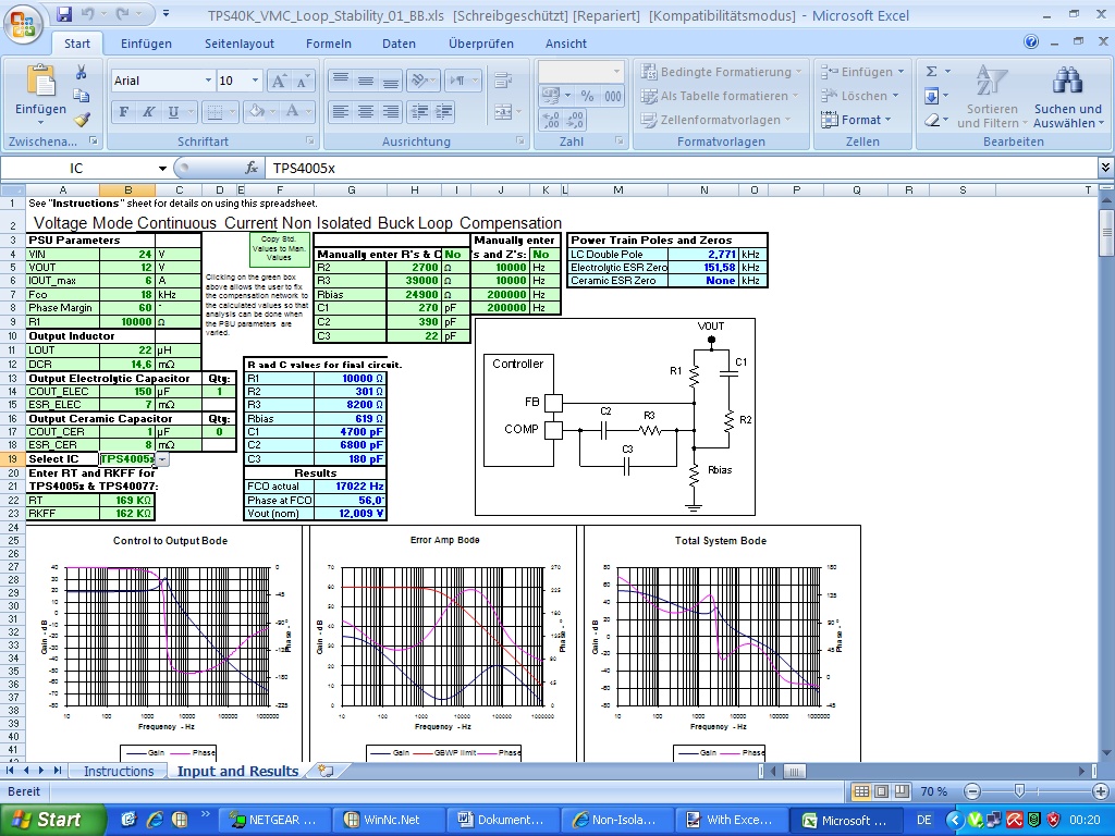

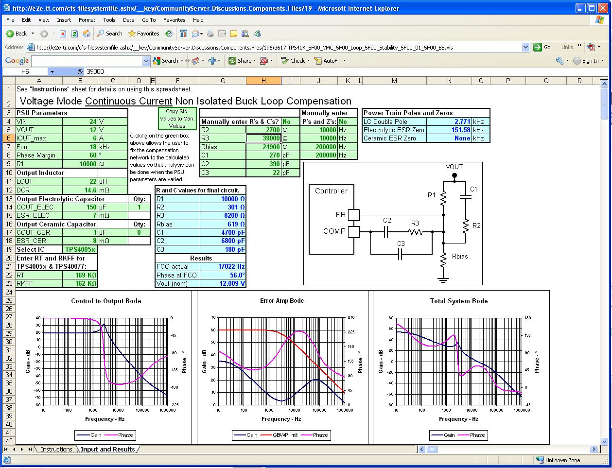

  • Bizhan,
    I've attached a screen shot of the file you sent me.  It is calculating component values and generating graphs as it is intended when I open it.  I am not sure why you are having an issue.  Could you take a screen shot of the file when you have it open so I can see what error you are having?
    Regarding your snubber summery, everything is correct.
    Equation 3a and 3b will simplify to: C + Cp = 4Cp or Cp = 1/3 * C
    This will help you solve for Cp and Lsl more easily.

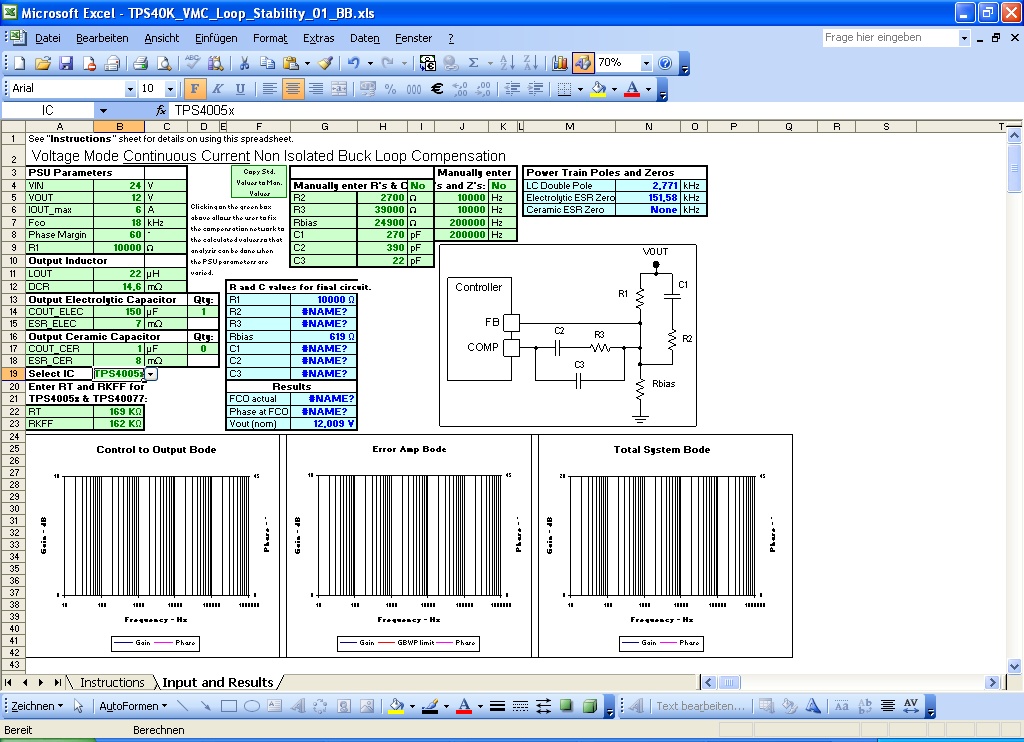

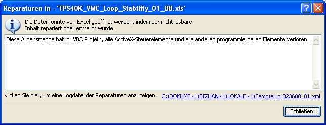

  • Dear Peter,
    I use Excel 2003 German. I have checked the problem with other versions of Excel. Here is the result:
    - It doesn’t work with Excel 2003 German.
    It works with Excel 2007 German. But after opening the file, Excel tries to repair it. You get the same result with original file of TI.
    - It works with Excel 2003 English.
    I’m not sure but I think that it’s a bug in the original file. I will use Excel 2007 and it’s ok.
    Best regards, Behrouz
  • Behrouz,
    I am afraid I don't read German, but I asked one of my German counter parts to read the error message and suspect that the issue is a conflict between the script functions and macros used in the spreadsheet and the security settings in the German Excel 2003.  Check your security settings in Excel and see if they are set to allow VBA and ActiveX script execution
