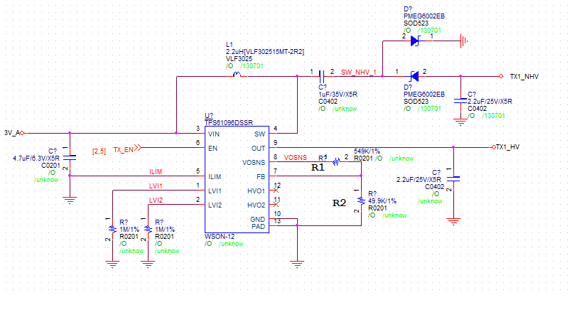

Hi Sir
May we check if we can reduce output capacitor? due to customer having board size concern and want to reduce output capacitor.(datasheet recommend 10uF ~ 100uF)
Vin:3.3V
Vout:15V Iout:3mA. another project is Vout 20V Iout 3mA.
