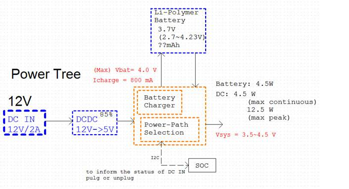

Currently we survey BQ25895 in our application, but have some question need you help.

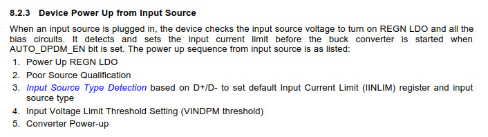

May I know D+/D- can floating since in our application is not use.  Acording to BC1.2 D+/D- need pull high or pull low?
Block Diagram as below
Battery capacitive 5200mAH, if you have better solution please advise me, thanks.
  • Hi Wen,
    If not used, then I suggest connecting D+=D-. This sets the input current limit to the LOWER of the value set per the ILIM resistor (if enabled in I2C) in standalone mode (no watchdog ping) or the value per the I2C ILIM register when in I2C mode (watchdog is being pinged or disabled).
