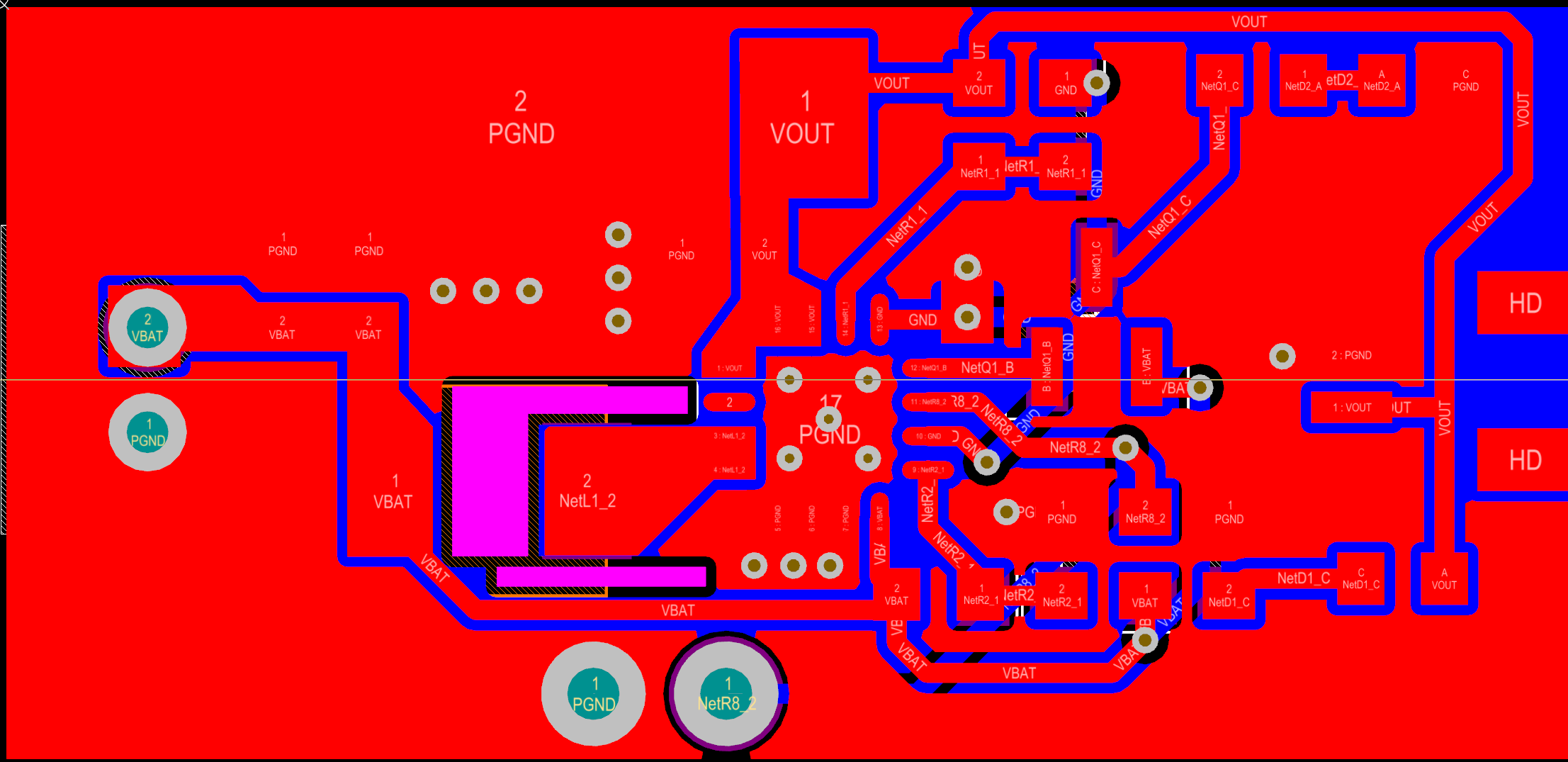

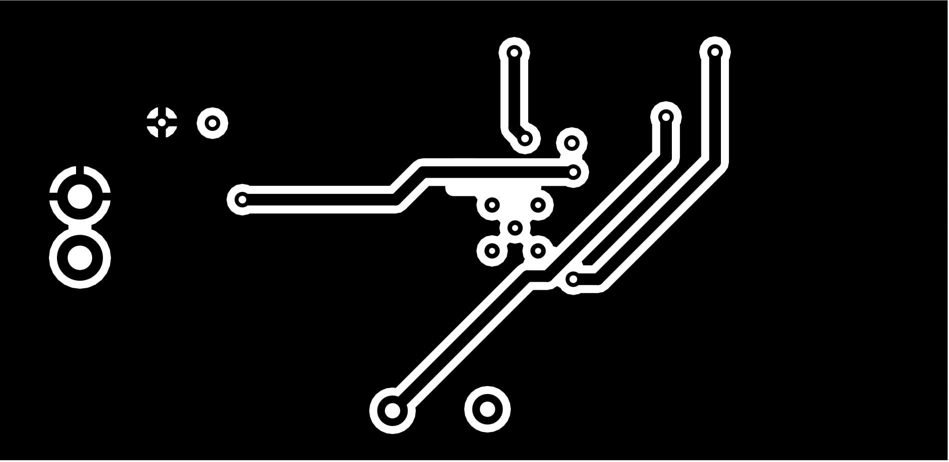

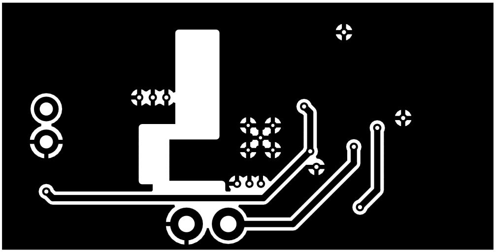

  • Here is the updated layout:

    For the PCB layout

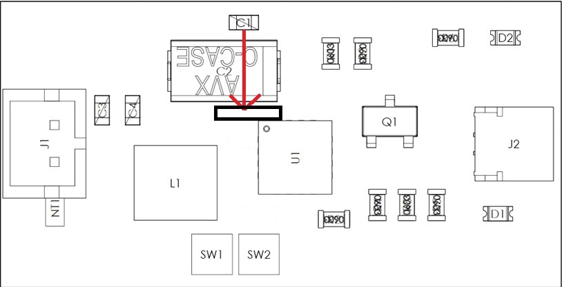

    1. i would suggest change the C1 to a 0805 package ceramic capacitor, and placed as following figure. the SW can route under the capacitor.
    2.  the Polygon Connect Rule change to "direct connect" in stead of "relief connect"
    3. the signal GND should connect to the PGND between  the input capacitor and the output capacitor C2

    The C1 move won't work.  I added this snap shot so you can see the nets and know how things are.
  • What does the pink area stand for?

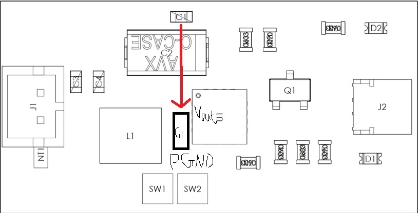

    what about move the C1 here, and place 4 vias closed to the PGND node of the C1, although not good as the former one, it should be also OK.
  • Pink is a keepout area so that I don't get ground pour under that inductor.
    Okay here are the updates with C1 move:
  • One more place can be improved:
    in the schematic, connect the pin 2 (NC) to PGND.
    then in the PCB, the PGND of the C1 can be connected to the thermal pad on the top side. this will further reduce the parasitic inductance between the IC and the ceramic capacitor.
