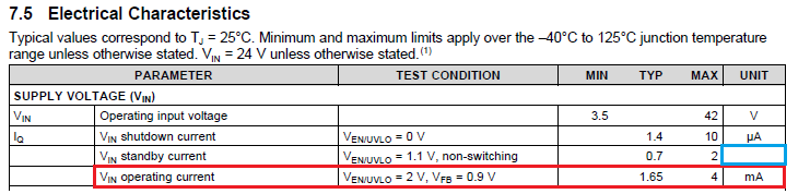

My customer considers to use LM5175 and have two questions about supply current.
1)
There isn't unit for standby current (blue part). Is it "mA"?
2)
Vin operating current shows 1.65mA(TYP).
Is the value under no load and DCM condition?
Yaita
    The IQ is mA. The unit term was supposed to be common for standby and operating current rows.
    The operating current of 1.65mA is for no switching condition. The rest of the controller including all the bias circuits are active.
