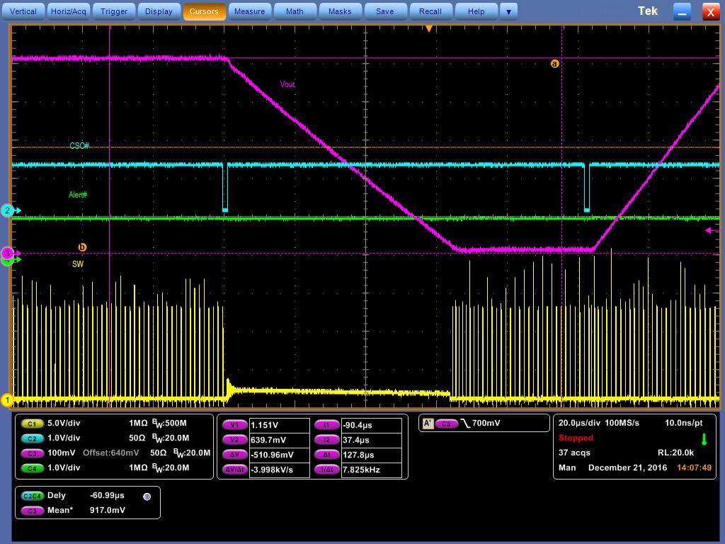

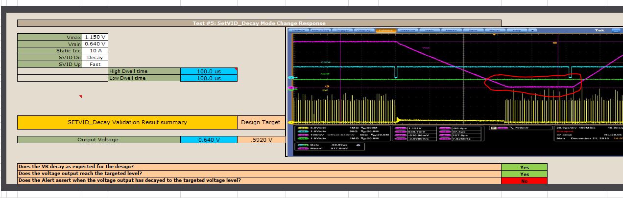

                 Customer test intel spreadsheet. When output voltage decay to 0.64V on 10A, The alert not assert. Per spreadsheet, it needs to decay about 0.59 V the will send alert. But the output of TPS53625 can't decay more below 0.64V even we add 20A load. Has any suggestion why output voltage can't decay more? Thank you.
