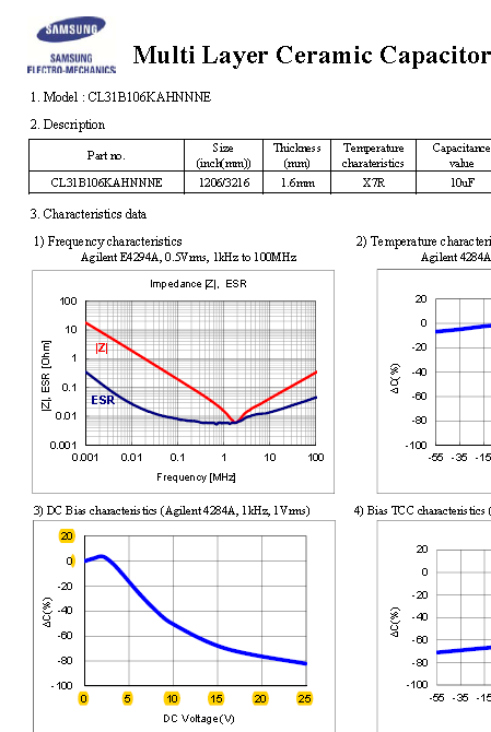

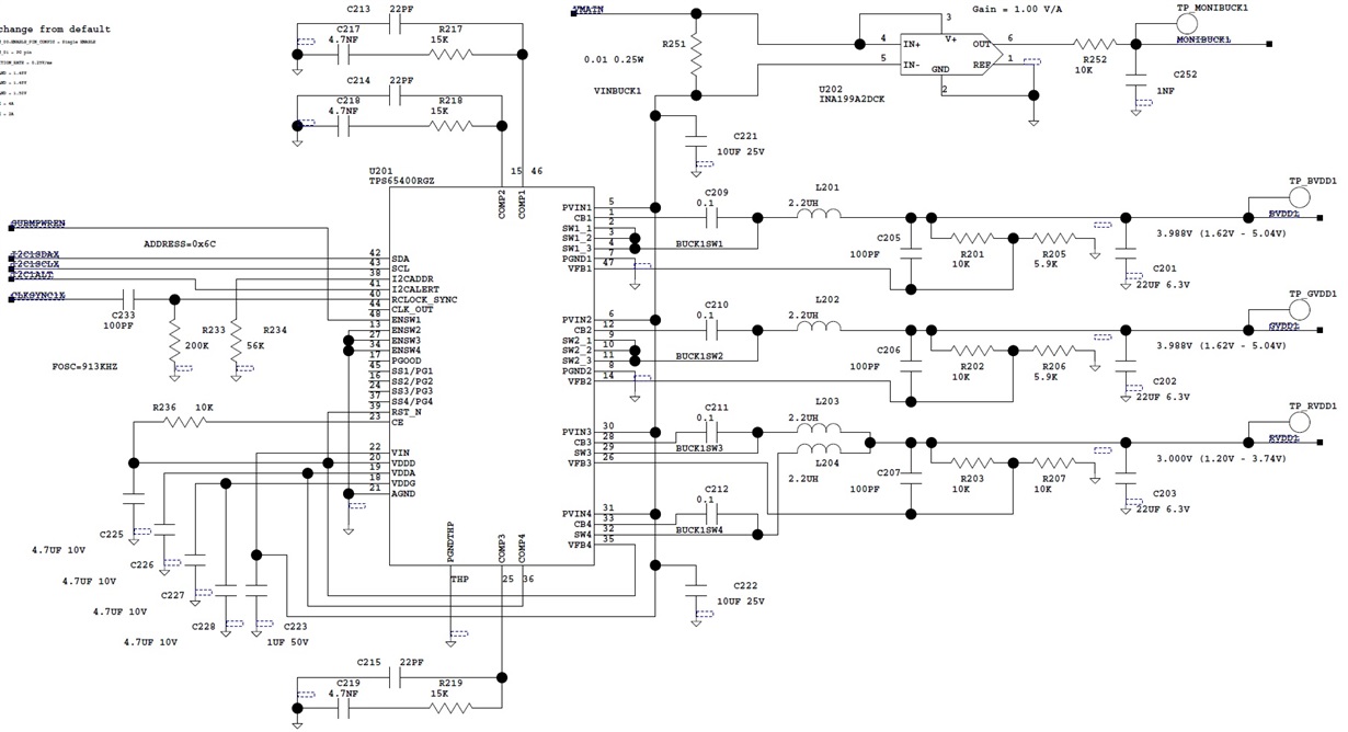

    My capacitance being used is Samsung CL31B106KAHNNNE.  Attached is my schematic.
  • Hi Henry,
    Yes, the 10uf u used is 25V but the DC bias looks not good, alomost over 60% derating. the real value maybe is only <5uf@12V and so more caps is needed.
    and the draft calculation is for deltaV, if deltaV is very big, then which indicates the Vin will goes down a lot.

    Finally, I see there is a current sense resistor in the PVin loop, did you try to remove or short it and re-test to check if there is any promoted?

    2,Did you disconnect R251, U202 and add external 12V power supply to PVIN to double check the oscillation?
    3, BTW,  the PVIN cap should be placed colse to PVIN pin,

    You got it!  Once I connect the power directly to the PVIN pin, the oscillation goes away.  Then I suddenly realized that I had an input LC filter to this circuit before the R251 resistor, and I was supplying power through the LC filter.  The LC is 10uH and 40uF which calculates to a 8kHz resonant frequency, then once it coupled with the negative input resistance of a buck converter, it became a perfect oscillator.  Now even if I connect the power directly to the LC filter output, there is no oscillation.  This means that it is the 10uH input inductor that caused the problem.  But for the design, I have to keep the inductor, so I have to really push down the input filter corner frequency by replacing the 40uF with something much bigger.  Maybe you can point me to some application note to show how to select the proper input filter to avoid this problem.  Again, Thanks a lot for your suggesstion.
