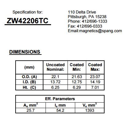

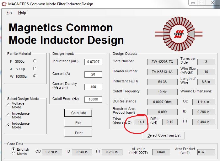

Can anyone guide me how to match theoritically the temp rise calculation with the design tool...
i have tried using these equation
Where R is the outer dia of the core in cm
          r is the inner dia of the core in cm
according to this equation i am getting a temperature rise of 10 degee c
  • Sudeep,
    Thanks for your interest in TI here. To assist us in helping you, can you provide information on what tool you are using here? I don't believe that is a TI tool from the image.
    Can you give some information about what type of power converter you are designing? Input voltage range, output voltage and power?
