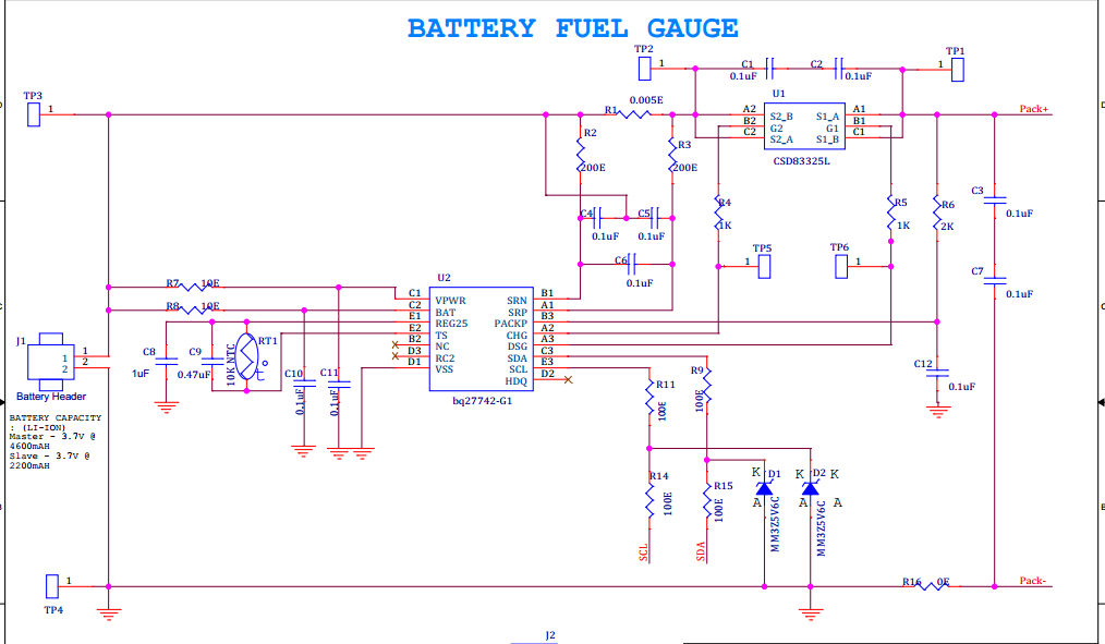

Hardware schematic as shown above.
when i'm applying  vcc to pack+ my device is started and  i get the vcc voltage at Pack+  then after i'm successfully read data.
But when i'm writing data the ic pack+ voltage level to 0 v.
In this case i have question that if I’m unseal the ic  voltage avail at pack+ or not.??

    You want to apply power to the VPWR pin while programming (preferably through the battery header instead of the Pack+ pin). Make sure to write the updated checksum (0x60) after writing the new capacity. After programming check your flags register if CHG and DSG are set or cleared.

    Right Now i'm giving supply from Battery pack already. but not getting output +vcc directly to pack+ if i'm provide vcc voltage to +pack manually thereafter pack+ give vcc output same as battery voltage level.

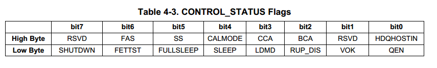

    I want to change "Design Energy Scale " through I2c interface.
    When I'm Trying to write Data into control()  (address 0x00)   (data (0x13))  after that device is not giving acknowledgement.
    and output  of voltage level at Pack+ down To the 0 Volt.
    i have question that after write to the control()  (address 0x00)  to 0x13 to Q max update fuel gauge is in sleep mode or working in normal mode.
    when i'm  writing 0x13 it is going to sleep as per datasheet register description so after sleep mode we can communicate over i2c or not.
    if i'm going to write only 0x03 in this register so there after i can update the Design Energy Scale " through I2c interface.

    On the bq27742, writing 0x0013 to the control register is actually the SET_SHUTDOWN command. The code in your .zip is for a bq27441-G1 which is a different gauge. Some of the commands are similar between the two gauges, but many are different.To modify Design Energy Scale, you want to access Subclass 48 (0x30), Offset 23.

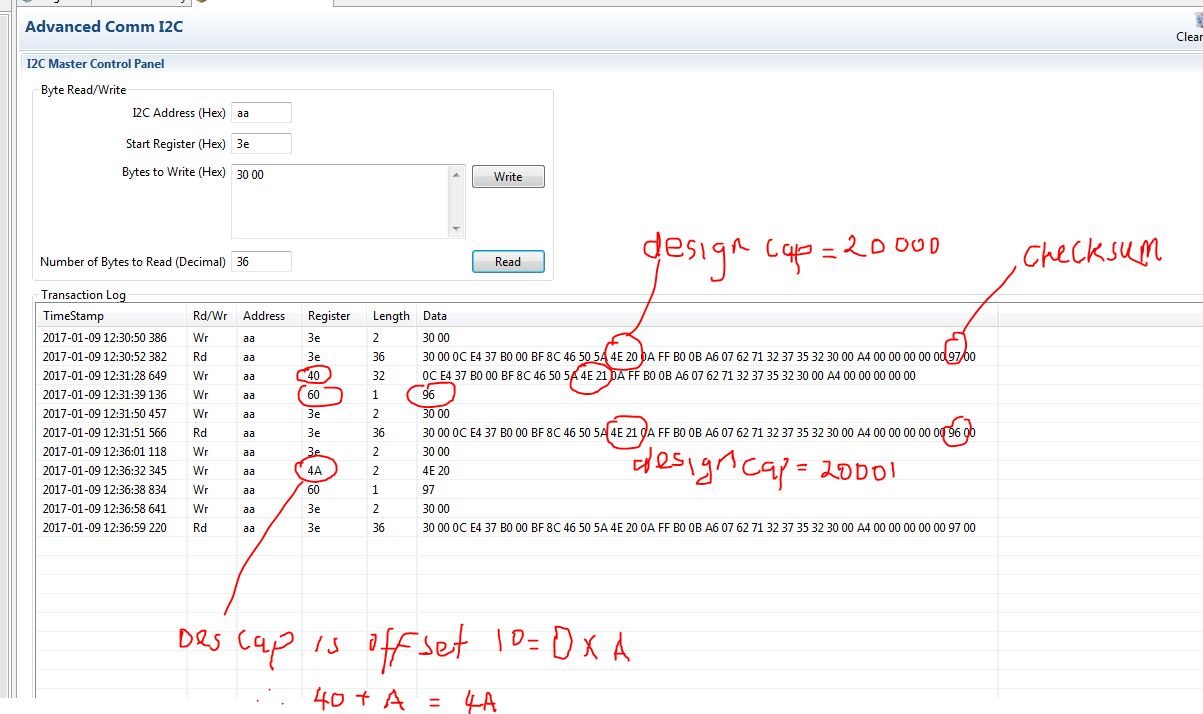

  • Hi Kalarav
    My attached snap shot shows two methods for updating the design capacity.
    The first method is as follows:
    The subclass id for design capacity on the gauge i am testing on (bq27520) is 0x30.  The offset for design capacity is 10. The  data flash command code is 0X3E. Block data checksum is 0X60. in example data flash design capacity was 20000. in hex 4E 20. I am changing to 20001.My checksum of the data block is 97. In hex that would be 4E 21. My checksum i calculated would be 96
    W 3E 30 00
    W 4A 4E 21
    W 60 96.
    The other option would be to write the entire block data (block data is from 0x40 to 5F), and then write the new calculataed check sum . This method is useful if multiple parameters within the same block of data needs to be  changed.
    W 30 00
    W 40 entire data block with the changed parameter
    W 60 96
    I have attached an excel document for calculating the check sum of data blocks.
    DataFlash_write_checksumcalculator.xls
    thanks
    Onyx

    as per your suggestion i'm successfully write design capacity and Read same from its address.
