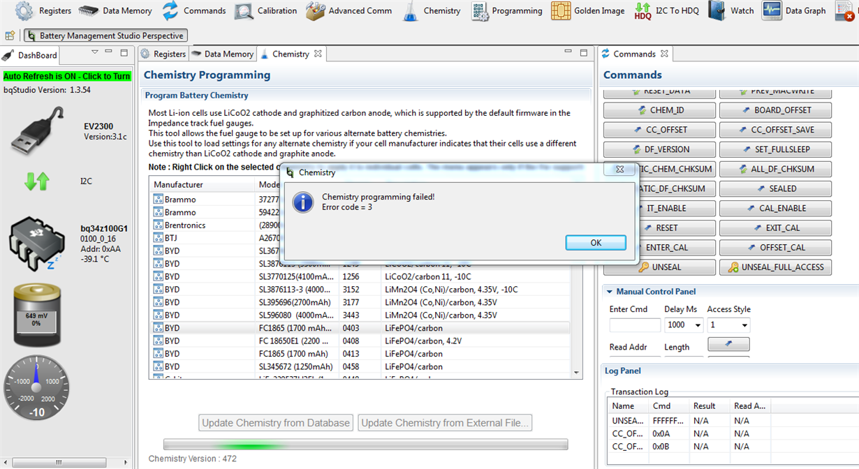

  •   I try to configure the batery but i received this error:
  • Sorry I didn't it well before.
    I am trying to configure the battery and I want to select this one because it is the most similar to the one I use,but I can't and Bq estudio always gives me this error.
    Does anybody have any suggestions?
  • Ismael
    You can try using this .bqz file. Please it in the this directory.
    C:\ti\BatteryManagementStudio\config
    https://e2e.ti.com/cfs-file/__key/communityserver-discussions-components-files/196/0044.0100_5F00_0_5F00_16_2D00_bq34z100G1.bqz
    If that does not help, then you can try downloading the latest version of bqStudio from the TI website.
    Tom
