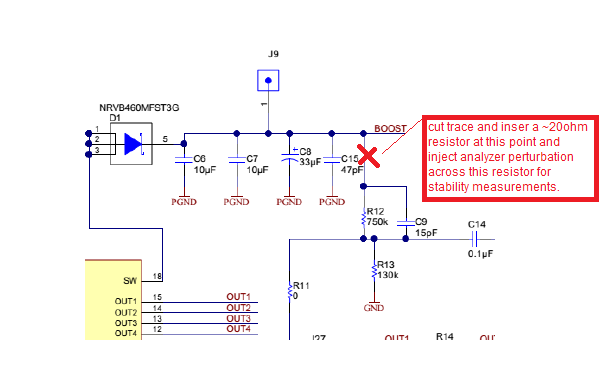

Hi, team.
Please tell me method for measurement of the loop stability of tps61194-Q1.
Where should a loop analyzer be connected?

Kobayashi-san,
Yes this location is correct for TPS61194-Q1 for stability measurement.
