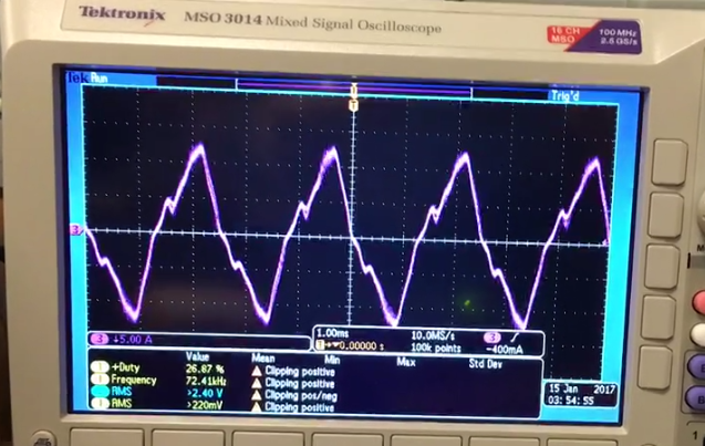

We tried running the PFC (in interleaved configuration) with 400Hz input. However, the system never goes into regulation. Debugging further, we see that it doesn't leave the IDLE state at all, because of the VAC limit checks:
    if(( iv.vin_squared_average > VAC_MIN_ON_SQ_AVG) && (iv.vin_squared_average < VAC_MAX_OFF_SQ_AVG) ) {   ...   }
Is there a problem with the vin_squared_average calculation? It appears to be dependent on the frequency. If anyone got the PFC working with 400Hz input, we'd like to hear any input about the process.

  • Hello Ian,
    We completely re-wrote the half_cycle_processing function and now the PFC starts running.
    However, we are running into newer problems. First and foremost, our current waveform is very distorted for 400Hz operation:

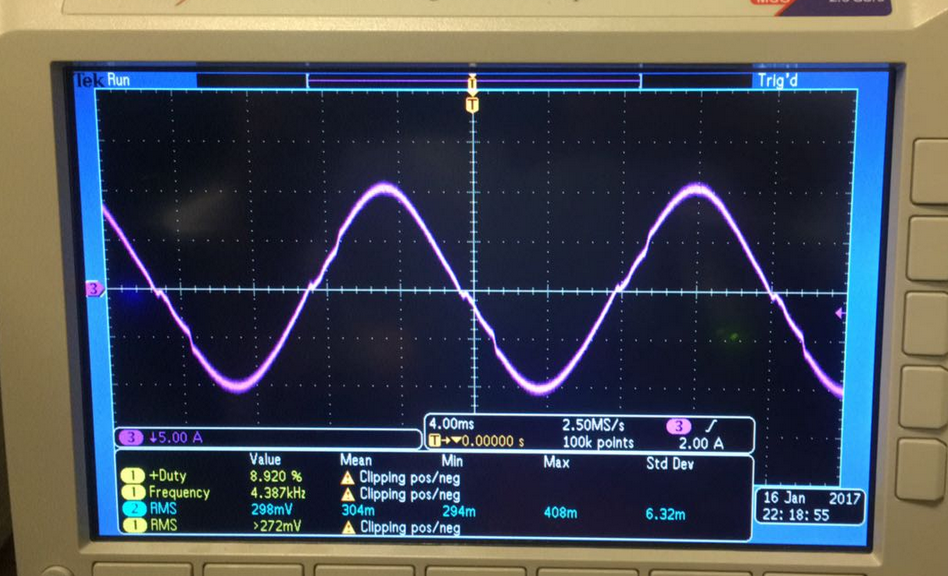

    Here's the 60Hz waveform for comparison, which is much cleaner.
    Probably some computation somewhere is using stale, slow data, but we can not find out exactly what is going on?
    Do you have an idea where the problem might be, by looking at the above waveform?
  • The first things you need to change are the coefficients for the current compensation, which you should be able to do using the fusion GUI.  You also need to change the hardware EMI filter on the input.  They are currently optimized for 50 to 60 Hz.

  • The waveforms look to us like waveforms that need the coefficients and EMI corrected.  I agree that there may be other issues hiding, that's why I said the compensation and EMI are the first things you need to do.   After that, if necessary, we can continue to peel the onion.
