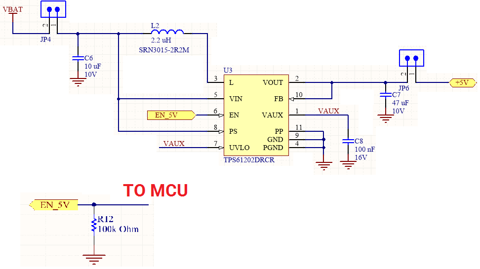

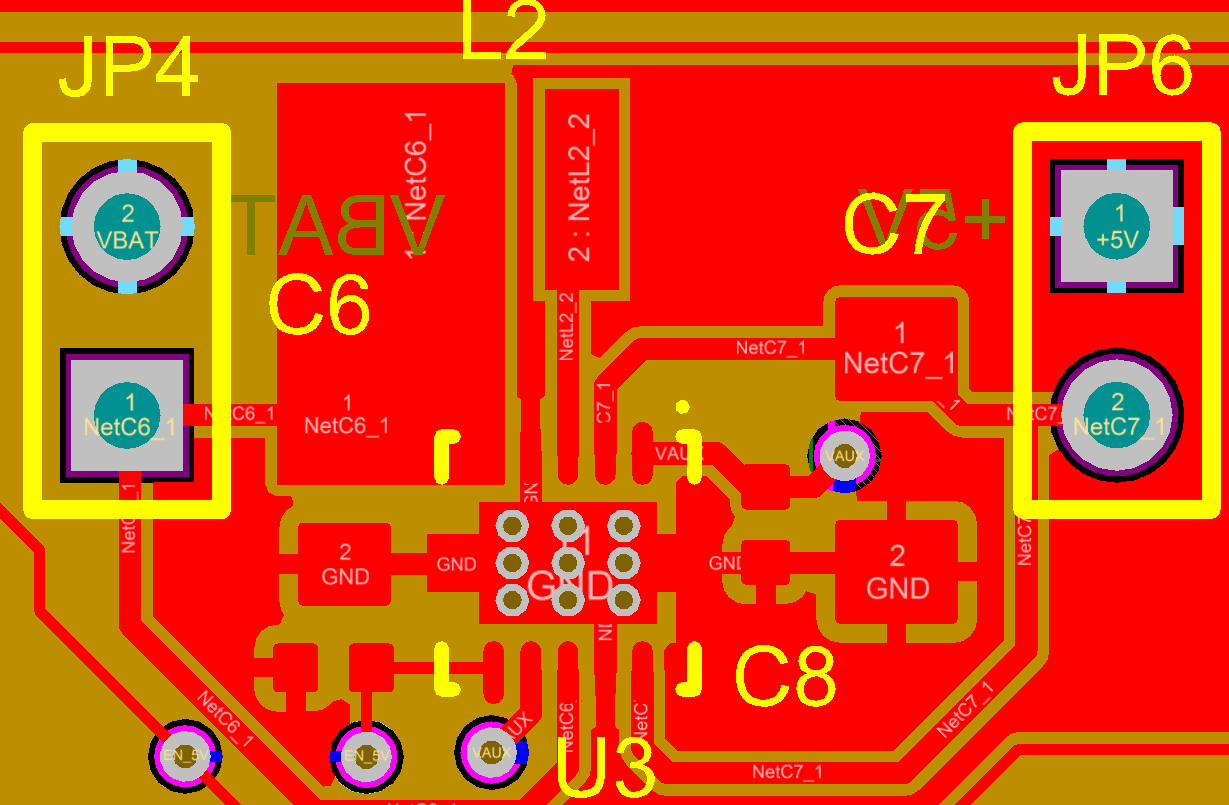

Schematic/layout are below. Tested on multiple boards and platforms (even a modular platform which doesn't have any load connected on the boost output). Problem is high static power consumption (9-10 mA) of boost when enabled and no load attached (power save is disabled: PS connected to input). EN is pulled down (100k) and controlled by a 2.8V powered host. UVLO is disabled (connected to VAUX). Following is the details of the tests and my findings. Any help would be greatly appreciated!

Test 1)
INPUT: Li-Po battery with Voc = 3.8V
OUTPUT: 5V, no load (floating)
When the host enables the boost, it sinks 9-10 mA of static current (JP4). Expected 70 - 100 uA.

  • hello
    please enable the power save mode if you requirement small input current at no load condition. if the power save mode is disable, the device keeps switching with approximately 1.4MHz even at no load condition, which consumes large input current.
    could you connect PS pin to GND and measure the input current again?
  • Hello. I just confirmed my measurements with a TPS61202EVM I received. I measure 7.75 mA with power save disabled and 128 uA with it enabled (no load). The enable pin is controlled by our host so we will turn it off when not used, but I will keep that in mind for a future PCB revision.
