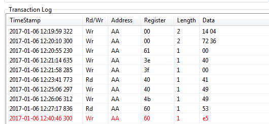

I am trying to configure my bq34z100evm to be able to take votages above 5 V. How do I set the VOLTSEL bit in the Pack Configuration register  in bqStudio?
  • The VOLTSEL bit is located in the Pack Configuration register. The bq34z100EVM User's Guide provides guidance on setting up and using the EVM.

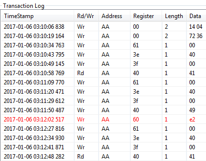

  • yes but i am having trouble with the notation to calculate NEW_checksum. I do not get acknowledgement from the device when I write the NEW_checksum to BlockDataChecksum() (0x60). Can you clarify the notation: for example, if I have mod(107, 256), does this not equal 42?
  • Furthermore, why can't I unseal the gauge using the Advanced Comm I2C pannel? It works when I use the built-in commands but not when I do it with the Advanced screen.
  • Mark,
    Make sure that no I2C communications, such as scanning or the Dashboard, are active while running this procedure. Here are the steps to unseal, read the Pack Conf, write the VOLTSEL and verify the Pack Conf.
    Tom

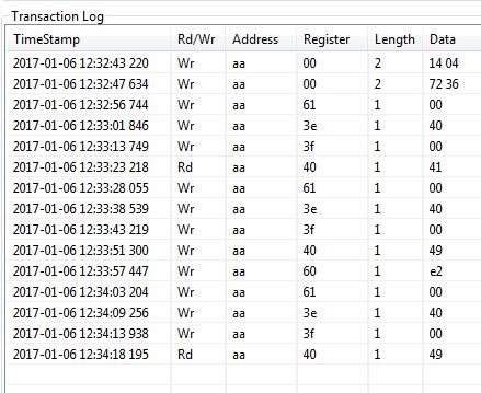

  • OK. Turning off the dashboard helped in that I can now unseal the IC from the Advanced Comm I2C screen, but the IC will not acknowledge my checksum, still.
  • The E2 checksum applies to the 32 bytes of data in my device. There must be difference in yours. Read the checksum after you read out the 41 and let me know what it is. I should be able calculate to new checksum for you.
  • It is 0x53. I calculated the checksum to be 0xE5 using the method described in the user guide, but this value does not work. Thanks so much Tom.
  • I calculate the new checksum to be 4B.

  • Thanks so much Tom. The value you calculated worked. The values 255 & 256 in the formula made me think the formula was in binary. I do have another issue though:
