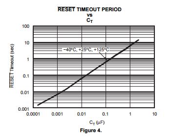

- They want to estimate /RESET delay time by below equation.
   /RESET delay time = Ct * Vct / Ict + 500us
  They think 500us is internal delay time. So they want to know the variation of 500us.
  They don't need the gurantee. They want to estimate the variation of /RESET delay time.

    The 500us does come from internal delays as you mention.  The variance of the 500us is negligible across temperature. Please note that Figure 4 shows that the timeout period is consistent across temperature.
