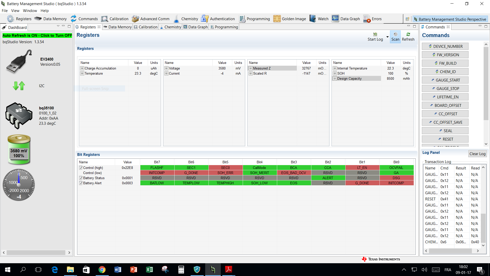

I have just started using the BQ35100 EVM with a LiSOCl2.
(1) I was unable to locate LiSOCl2 batteries in the chemistry database; I kept the default one.
(2)  Configuration of EOS mode is OK. Voltage, current and temperature readings are OK, but when issuing GAUGE_START/GAUGE_STOP commands sequences, the measured Z gets higher and higher and goes into saturation (i.e. 32767 or -32768). SOH_ERR and EOS_BAD_OCV are set.
Resetting the chip cause the measured Z to be reallistic againt (i.e. about 300 mOhms), but then measured Z gets erratic again (and increasing) when issuing new GAUGE_START/GAUGE_STOP sequences.

  • Hi Jean-Philippe,
    You will need to update bqStudio chemistry database: http://www.ti.com/tool/GASGAUGECHEM-SW. The chemID for LiSOCl2 should be 0607. ChemID 0606 is a generic ID as well.
    When you issue the GAUGE_START command did you applied a discharge load then remove the load and allow the cell to relax before issuing GAUGE_STOP command?
    What you should do is apply a discharge load then issue gauge start then remove load and let cell relax. This will update your measured Z correctly.
