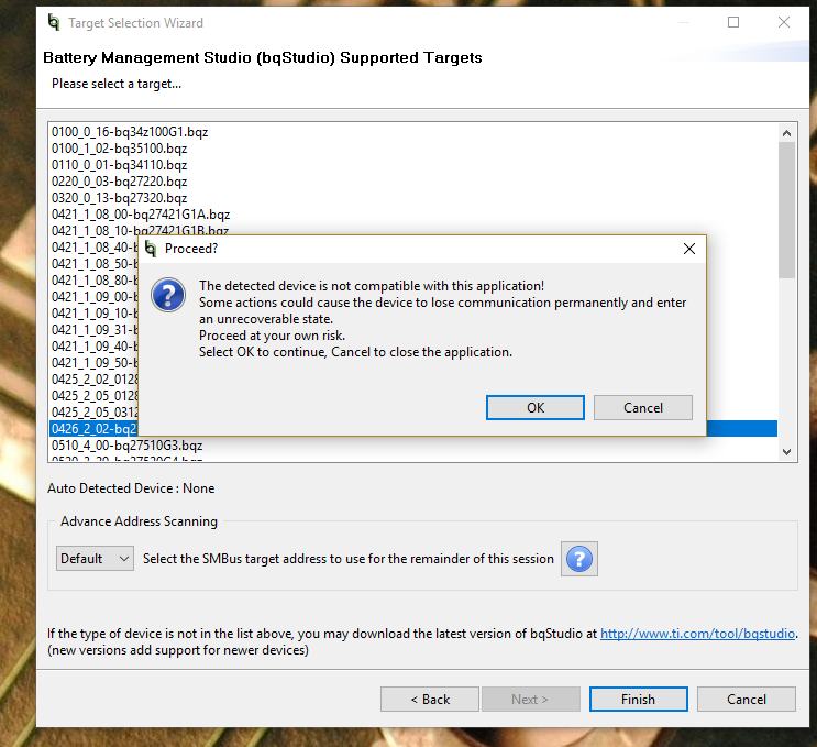

I connected a custom board with a BQ27426 to an EV2400, connected in turn to a computer running BQStudio. BQStudio is able to identify the device (which is listed as 0426_4_26), but says it's not compatbile with that version BQStudio (v1.3.54, which I downloaded today). There is a listing for 0426_2_02-bq27426G1.bqz, but BQStudio claims they are not compatible, and that using it could brick the device. What should I do?
  • I still haven't been able to get BQStudio to work, which I need to in order to generate the golden image. I noticed that if I select 0426_2_02-bq27426G1.bqz the only available bqz, when it scans for it, it does so for address 0x17, but the correct address of a bq27426 is 0x55, what gives? Maybe I'm missing a more up to date .bqz file?
  • Please attach a screenshot of bqStudio after you select the 0426_2_02-bq27426G1.bqz file manually.
    bqStudio will scan at address 0xAA (=0x55 7-bit notation). When do you notice that it uses 0x17?
  • I only saw it scanning for 0x17 a couple times, I cannot reproduce that today.
    This is the screen that comes out when I select the .bqz file.

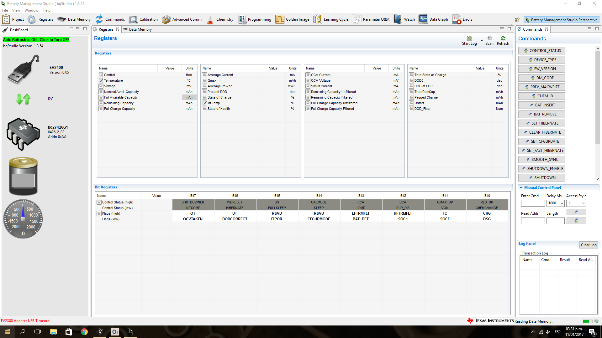

    Today I got a different error message after selecting the gauge: the program claims to be connected to the gauge via I2C using address 0xAA (0x55), but no values are being read, and I get an "EV2X00 Adapter USB Timeout" error (bottom left). When I first plugged the adapter to the computer, the software asked for me to perform a firmware update, which I did.

    PS: the EV2400 is connected to the I2C bus of our custom board (via the SCL, SDA and VSS pins of the I2C port, labeled as "PORT 2" on the plastic case. That I2C bus is active (because our firmware is performing a series of tasks): is it possible that this activity is causing problems with the EV2400? There is plenty of bus availability, the bus is only used for about 20% of the time.
  • Are you able to communicate with a bq27426 EVM and the EV2400 (as to rule out interference with another I2C master)?
