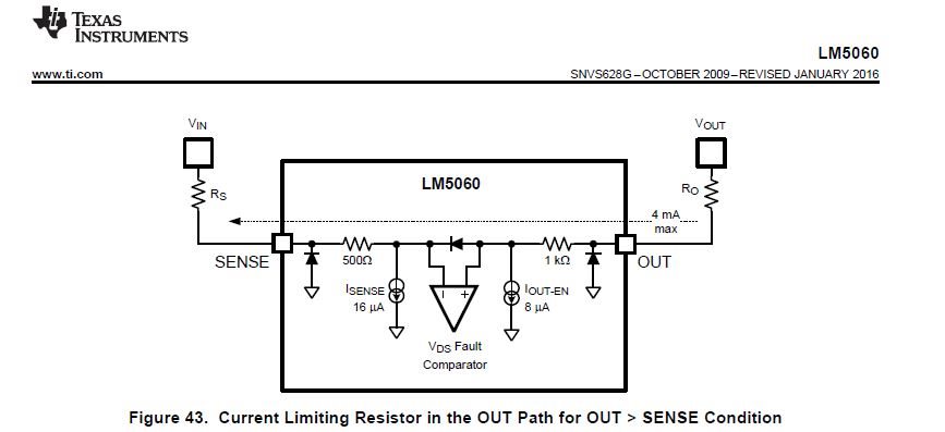

I would like to know what is the current limit if I set the circuit below for Ro=Rs

Welcome to e2e! Our team has created these nifty design calculator tools to help with picking the right values for our parts. Our customers love them and there's one just for the LM5060, with an option of using Ro in the circuit (make sure to click yes on the drop-down box for "Reverse Polarity" on step 2). The calculator tool will help answer your question.
You can find it by going to www.ti.com/hotwap ==> click on “Tools & software” ==> then click on “Hot Swap design calculator tools”
To better understand what each cell means and how to enter the correct value, we have video tutorials on how to fill out the hot-swap design calculator spreadsheet. The videos are at www.ti.com/hotswap ==> Click on “Support & Training” tab.
