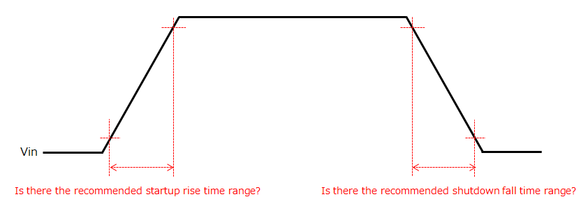

TPS54628: TPS54628 VIN startup rise time and shutdown fall time
Part Number: TPS54628
We got a question from customer about TPS54628.
Could you help us?
[Question]
- Is there the recommended VIN startup rise time and shutdown fall time range?

    Could you provide test condition of startup rise time range?
    They need this spec to certify their standard parts.

  • While the points that Ryan makes are valid, I think what you are looking for is the input voltage ramp up and ramp down minimum and maximum specification. So far as I know, that parameter is not characterized. I can offer some general guidelines though. TPS54628 can accept reasonably fast VIN rise and fall times, faster than 500 usec. You do not want to "hot plug" or apply the input voltage instantaneously without proper protective circuitry to prevent transient overshoot that could damage the TPS54628. As far as longer rise time for VIN, that is application dependent as Ryan points out and will depend on your output capacitance, output voltage and SS time. For longer VIN ramp rates, there are two specific conditions you need to be aware of. When the rise time is very slow near the UVLO threshold, there may be a toggling of the UVLO circuit. There should be enough internal hysteresis that you would never see it, but for a loosely regulated input voltage it is theoretically possible. The more likely scenario is the for higher output voltage like 5 V, extremely slow rise time on VIN may not allow the output voltage to get into regulation before the end of the SS time. You can account for that with appropriate SS capacitor selection. Extremely slow VIN ramp down may also cause your 5V output voltage to not regulate properly as VIN decreases towards the UVLO point.
