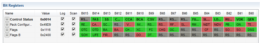

I am running bqStudio (version 1.3.54) on a 64-bit Windows 7 PC. I have the PC connected to an EV2300 (version 3.1r) which is connected through I2C to a bq34z100evm (firmware 0100_0_16). I am trying to get the gauge to read an accurate voltage as I have the BAT+/BAT- pins connected to the +/- terminals of a 12 V lead acid battery.
I configured the device to read voltages above 5 V by setting the appropriate jumpers on J5 and J2; I set the VOLTSEL bit in the Pack Cfg register; I entered the Voltage Divider parameter to 13000 mV (the max expected voltage), and I changed the Number of Series Cells to 6. Everything else is at the default settings.
I have 12.4 V applied across BAT+/BAT- but the gauge is reading 8.4 V. I am trying to calibrate the device but when I enter 12440 mV into the Applied Voltage box I get the error "calibration cell voltage is out of range. This value is in millivolts. Please check value and retry."  How do I fix this?
If it helps, the Control Status Register is 0x0014, and the Pack Cfg register is 0x49D9. Flags is 0x1116, and Flags B is 0x2400 (see pic below). Note that the CALEN bit in the Control Status register is cleared: am I supposed to be in some kind of calibration mode? The bq34z100g1 data sheet mentions a calibration mode but there are no clear instructions in neither this data sheet nor the EVM user manual. Can somebody help?
  • Mark,
    Did you place the .bqz file that I sent earlier into your bqStudio directory? There was a issue with a older .bqz. You could also try updating to the test version of bqStudio. The comment on the bqStudio product folder says that it is v42, but v59 gets downloaded.
    Try using this sequence and do not change the Voltage Divider parameter manually.
    •    Change the VOLTSEL bit.
    •    Change the number is series cells to 6.
    •    Calibrate the voltage.
    The register settings that you show look normal.
