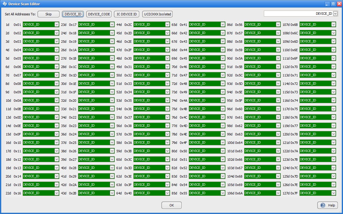

I bought some new UCD9222. I replace old UCD9222 with new one just for testing UCD. The board is same. Just UCD is changed. The picture of fusion software is shown below:
When I want to program UCD9222 with “TI’s USB Interface Adapter (2006)”, I encounter with this error : “No Devices Found”.
Device Scanning option is DEVICE_ID as before. Although I test all of options.

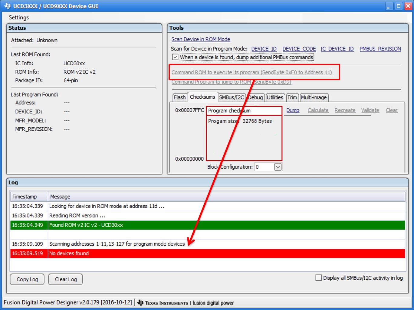

I used Device GUI to find more information. When I “Scan Device in ROM Mode” UCD30xx is found.
When I execute “Command ROM to execute its program“, No device found!!! It means no code in program flash. If I solder the old one, It would work correctly. The software version is ok. USB cable is OK. My PC works fun. Everything is ok. Just UCD9222 is the bad guy. I am far away from deadline. And so angry. I am loosing my job, money and every things.

  • GUI password is forestln.
    After entering the password, you can export Program Flash + Data Flash. Please export from a good device, in .x0 format, and download it to the bad device using Download Firmware tool under Tools menu.

  • Thanks alot for your help. You Save My Ship. I could read program of an old UCD and download it to new one. It solved my problem.

    I think the problem is with 42K ( date of production). The old one is 28K.
    I'll send you the exported Program Flash + Data Flash of 42K in x0 format, later.
