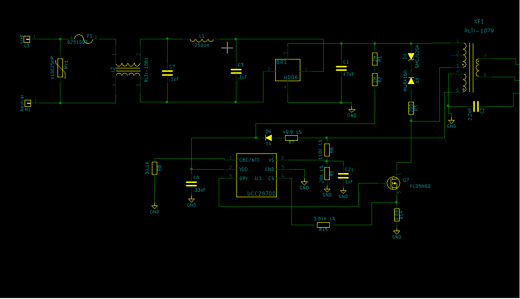

I am using the UCC28700 chip for a 5V 4.2A circuit. Every time I try to turn the circuit on the RCS resistor blows up. What could the potential problems be? I will add my schematic. The resistor value is R14 in my schematic.

  • Hi Hagen, I don't see any obvious errors in your schematic, so I think there must be a build or component error or something like that somewhere.
    I would recommend starting the unit up at a low voltage, possibly from a DC source and observing that the waveforms are as expected.
    See this video which explains what you should expect to see as you start up a UCC28700 based design.
    Hopefully if you follow through this it will help you accertain where the issue is.

  • what is the transformer?

    A review of the schematic diagram is a good place to start for debug, but it doesn't tell the whole story. As Billy Long suggested, there may be other problems not reflected on the schematic. Hopefully, the start-up procedure video that he suggested can help you with your debug.
    The "blow-up" symptom of failure indicates significant rapid overheating. Please verify that the power rating of the part used at R14 is suitable to the expected loss. Also verify that the part placed at R14 is the resistance value that is shown on the schematic. Presuming for the moment that it is properly rated, that implies excess current which points to the MOSFET being on too long.
    I discount transformer saturation for now, because I'd expect the peak current limit to cut the on-time very short, and the circuit should end up in UVLO "hiccup" cycling. Instead, I suggest to examine the CS input for proper signal. Be sure that it is not shorted to GND (its neighboring pin) through a solder-bridge or assembly mistake. The MOSFET is turned off when the CS voltage reaches Vcst(max) which is 0.75V in the UCC28700. If CS is grounded or stuck low, Vcst(max) is never reached, the second-level current limit won't work, and the MOSFET will stay on too long. There is a finite timeout for on time, but it is too long for all but the lowest input voltages.
    There is one other issue with this design: the schematic shows C21 (1uF) cap on the VS input. This cap should absolutely be removed! The VS input relies on the detection of several dynamic aspects of the auxiliary winding waveform and a capacitance on VS will obliterate all of those aspects. At most, a few picofarads can be tolerated at this node if necessary to suppress some noise, but no capacitance is preferred. I'm not sure if this has anything to do with R14 blowing up, but the 1uF has to go, regardless.
    I hope these points help you get your circuit working. Please let us know if this answers your question(s).

  • Thanks, I will try removing this capacitor.
  • sheesh! i was so focused on not knowing what the transformer was i did not even see that cap lol
