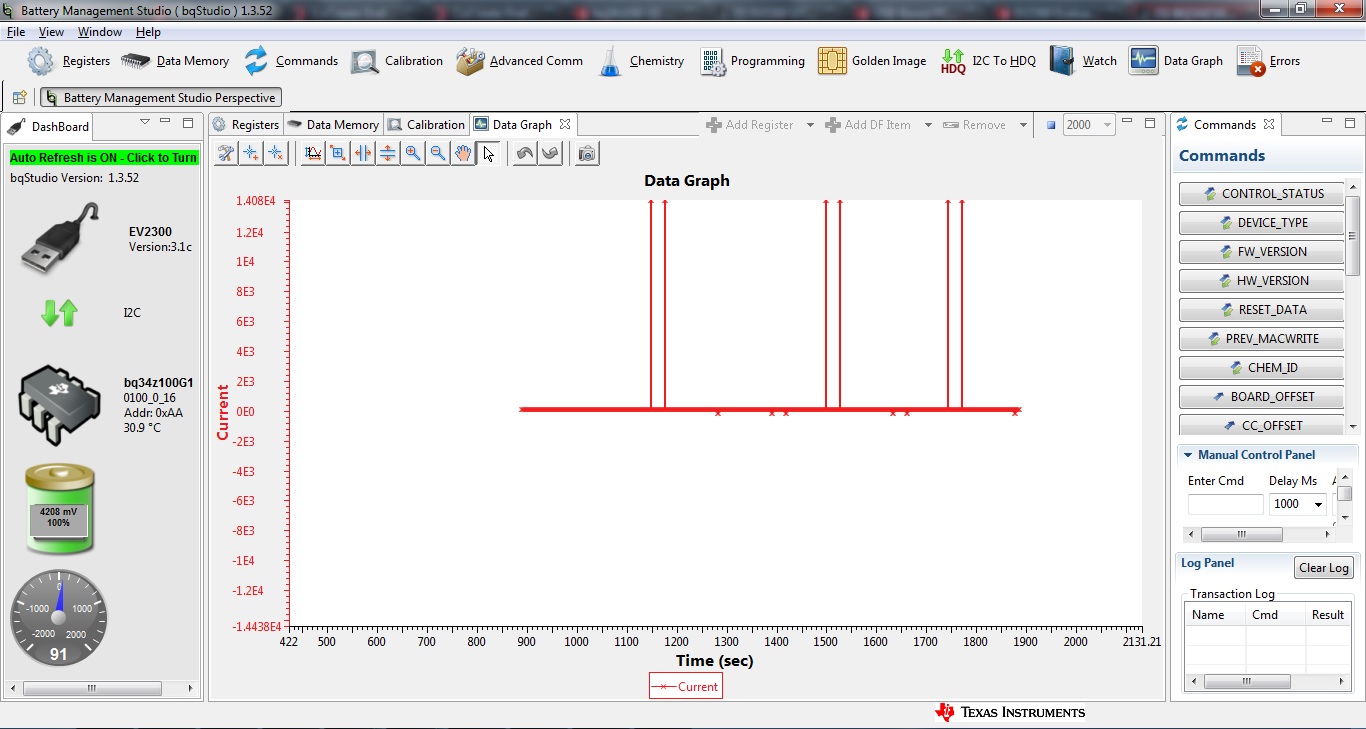

    Yes, I have some communication issues with bqStudio, I don't know why. I put 2x 10K pull-up resistors for SDA and SCL as suggested in the datasheet. Sometimes I cannot read the registers and sometimes the values aren't correct. For example, when I watch the current, there is some peak over 10A while the real current is about 250mA. It is like there is a synchronisation issue... do you have an idea about this issue?

    As well, I do not understand why I have some issues with the I2C communication. I use the EV2300 and I have 2x 10K as pull-up resistors. I measured the clock frequency (SCL signal) and I got 33 KHz for information. I thought it would be twice this frequency...
    I will attach a picture of the issue. As you can see, some registers (here the current) are not read properly some times... it seems to be periodical...

    But I still have the issue about I2C communication and I guess it might be the problem why the files I sent you some days ago were corrupted. Do you have an idea why I have these communication errors? I put 10K as pull-up resistors as suggested in the datasheet...
    Christian
  • I would check the I2C signal integrity with an oscilloscope to make sure that the signals are clean and meet the VIL, VIH and VOL thresholds. Is there just one set of 10k pull-up resistors on the bus? A common mistake is to have two sets of pull-ups and the effective pull-up resistance is <5k, which can cause communications problems.

    Here is the new log file but because of my I2C communication issue, there is a lot of NACK (err 722). I guess I have to fix this first. The log contains a discharge and the load were connected over night which is not good I guess, but maybe a problem happened before...
    I checked the I2C signal with the oscilloscope and I noticed a big problem : the rise time for SDA and SCL (10% to 90%) is about 2300ns and it should not be bigger than 300ns according to the datasheet (Vbat was about 3.05V). The fall time is less than 100ns which is OK. Pulse width are also OK (about 18us).
    Do you have any idea about the rise time issue? I will try to change the resistor values a little bit... and yes, I have only 10K, since there is not pull up resistor on the EV2300, I put 2x 10K (1x for SDA and 1x for SCL) on my PCB.

    EDIT : I did some tests... with 4.7K and 1K, I still have the I2C communication issues despite I got a good rise time with 1K. I don't think it comes from the resistor values... because it is not a "random error". What I want to say is that I am currently watching the voltage and the NACK happen after 16 seconds, then 28 seconds after, then 16 seconds again, 28... and so on...
    Any idea about what happen? Thanks in advance.

    The 2300ns rise time may not cause a communications problem as long as there is adequate setup and hold time. The voltage levels are more important with respect to detecting high and low bits in the transmission. I did notice from the screenshot that you are using version 3.1C firmware in your EV2300. This is an older version of firmware and some users have encountered I2C communications problems with it. We recommend upgrading the EV2300 to v3.1m or 3.1r to improve I2C performance. The upgrade procedure does require two EV2300 modules and here is an e2e link to the procedure.

    With the firmware 3.1r, the communication errors are solved!
