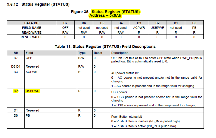

    In addition, I wanted to see if you could read the STATUS register (0x0Ah) in the scenario when you have shorted the AC input to the USB input. Would like to see if the device is detecting a USB source.

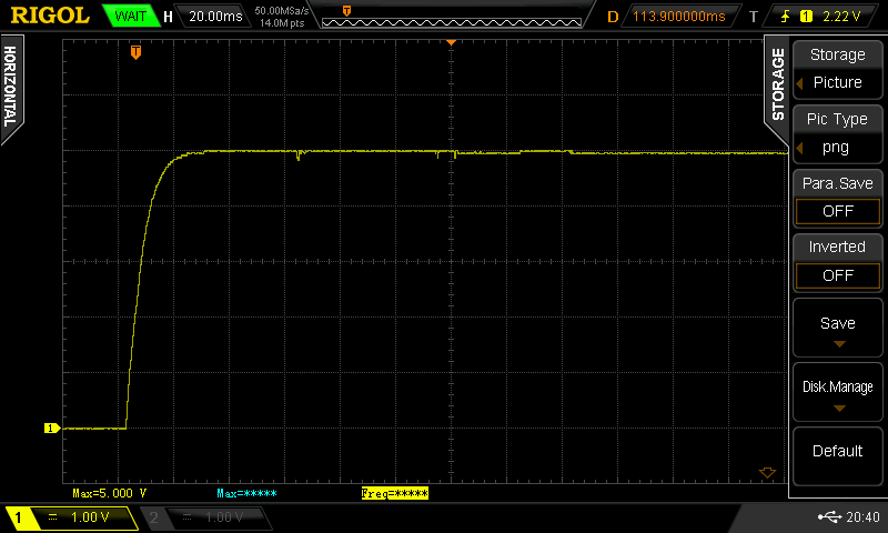

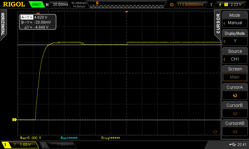

  • Hi Paul
    We have grabbed some traces of the good batch and suspect batch.
    Good Batch:
    Suspect Batch:
    Both traces were taken using the same DC power supply and USB lead.
    The value of the i2c STATUS (0x0A) register for the suspect batch is 0x0C = D3 & D2 bits set.

    Thanks for the schematic! Are both the boards the same? Do both the boards have the same firmware? From the above screenshot it looks like something is current limiting the "suspect" lot. Is something different about that board in terms of more current draw from the SYS pin? Since it looks like TPS65217D is limiting the current could you take a scope shot for the "good" and "suspect" lot? The three signals that would be of interest would be the USB voltage, the USB current, and the SYS voltage. It would as be helpful to see how high the current is for the two lots. If you could measure how high the current goes on the scope that would be great.
