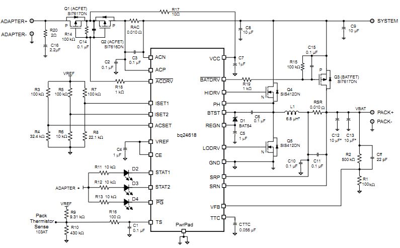

    The schematic is the same as the one provided in the datasheet, just only changing the values of the charge current an ac regulation set resistors. We also added another BATFET in parallel with Q3 to increase the current conduction capability of the circuit (BATTERY-->SYSTEM) The rest is exactly the same:

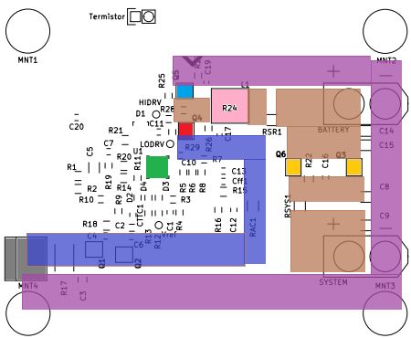

    This is the layout (some components might have a different reference number in comparison with the schematic showed above)
    • The grey block in the left-bottom corner is the AC adapter (19 Vdc)
    • Green central block is BQ24618
    • Red block is Q4.
    • Light blue block is Q5.
    • Pink block is the inductor (L1)
    • Orange blocks are Q3 and Q6 (Q6 is the additional MOSFET I mentioned above)
    • Light purple path is the Power GND.
    • Light blue path is AC Adapter positive path.
    • Brown path is: the charge path (Q4/5 -> L1 -> RSR1 -> BAT+) and the Bat to system path (Bat+ -> Q3/6 -> Rsys -> System+)
    • Analog groud is in the bottom layer, connected on the BQ24618 thermal pad. Power GND and analog GND are connected together by a single point right next to the thermal pad with a tiny 0 ohm resistor (in the bottom layer).

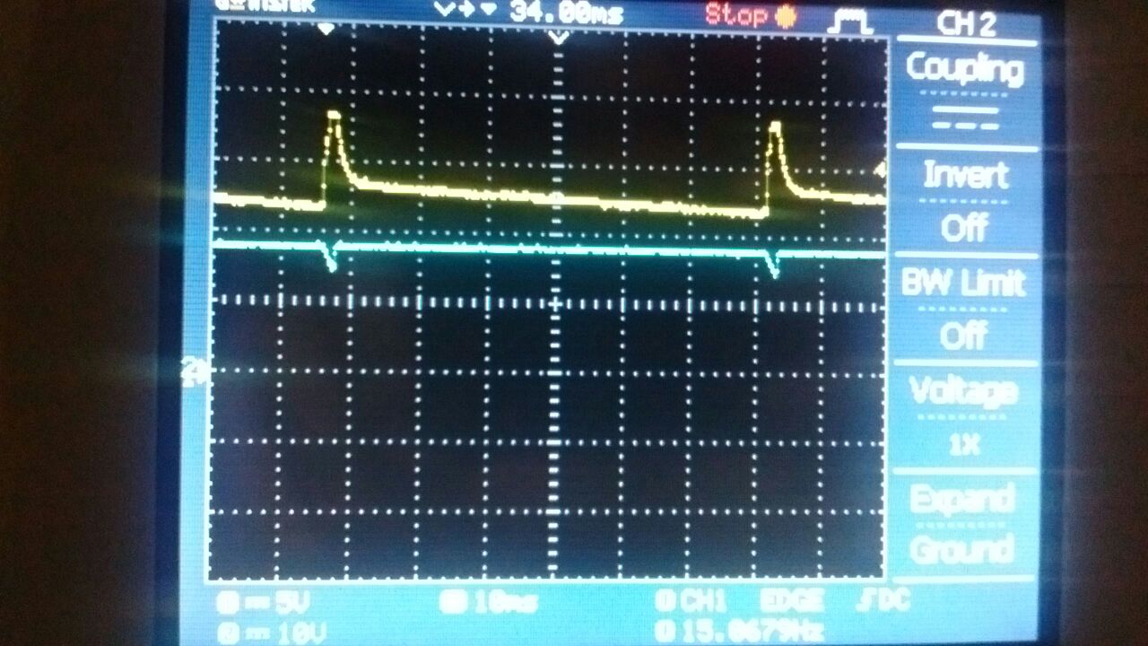

    • SRN:   Period: 68ms, Max voltage: 18V; Min voltage 16.7V
    • ACDRV (blue) and BATDRV (yellow):
    Additional information:
    /PG pin will blink with CE high or low and in the conditions measured above. It will only stop blinking when the battery is connected. But connecting the battery will make the AC adpater to supply a current twice the currentset in ISET1, ISET2 or ACSET. When connecting the battery we experienced overheating or destruction of Q4 and/or Q5. We tested another pcb variant with a RC snubber to prevent the accidental triggering of the MOSFETs when inserting the battery, but no improvement was appreciated (we proceeded to continue the tests without this RC snubber circuit)
