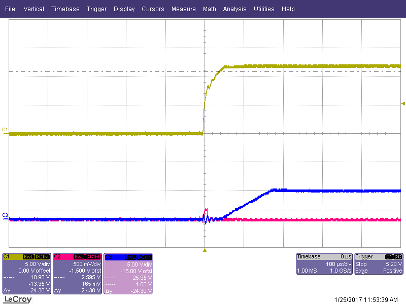

    OUTx will remain below 200mV at all times after VDD is applied until such time as the controller starts to generate correct pulses at the OUTx pins.
    I took the screen shot below this morning. You can see a small peak on OUTA to 180mV - OUTA increases with VCC until it reaches this point - this peak was absent when I reduced the dv/dt at VCC as you can see in the second image below.
    Yel: VCC
    Red: OUTA
    Blu: VREF
     VCC set to 12V, current limited source set to 2.0A. VCC applied through a switch to maximise the dv/dt. OUTA starts cleanly.
    OUTA was open circuit for this test.
     Peak OUTA voltage is 180mV
    OUTx events not correlated to VREF.

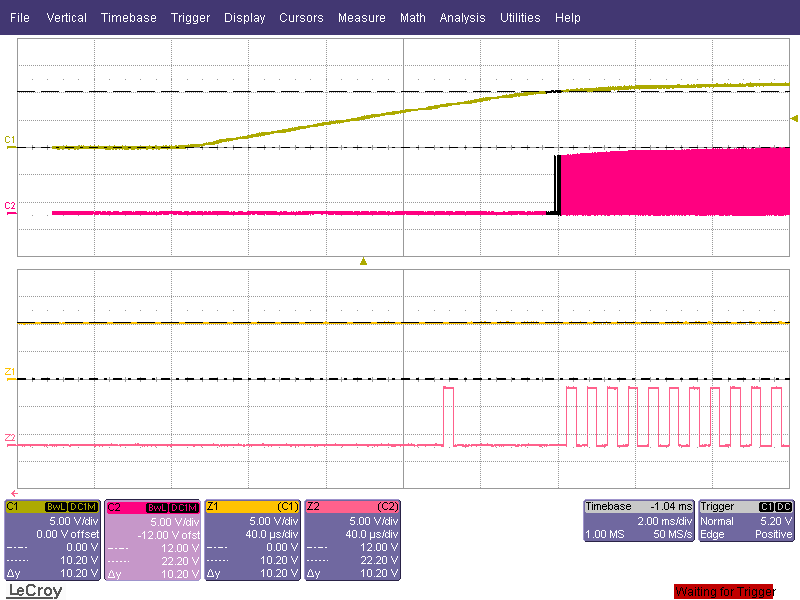

    Yel: VCC
    Red: OUTA
     VCC set to 12V, current limited source set to 130mA. OUTA starts cleanly.
    I hope that this answers your question, please let me know if you need any  more information.
