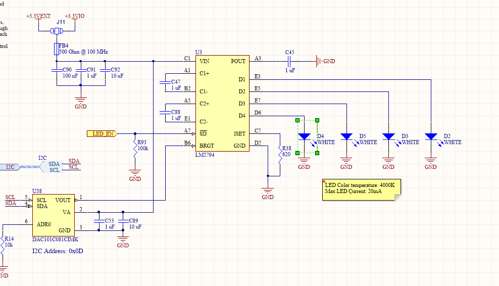

LM2794: LED's turning off with 8 second delay from LED_EN going low
Part Number: LM2794
We are having an issue with the LM2794 LED driver.  On a few boards (not all) that we have built, we see the LEDs do not turn off for up to 8 seconds after LED_EN is pulled low.  We also see this behavior get worse the higher we set the brightness control.  We have swapped U3 and the LEDs and this did not fix the issue.  We are in the process of swapping the capacitors to see if that has an affect.  Does anyone have any good troubleshooting ideas or have seen this behavior before?
