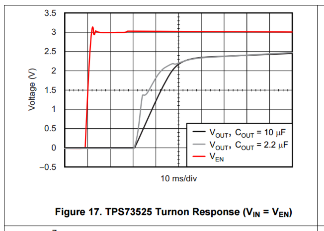

TPS735: It looks like there is a typo in the TPS735 start-up time graphs (And other Application Curves graphs)
Part Number: TPS735

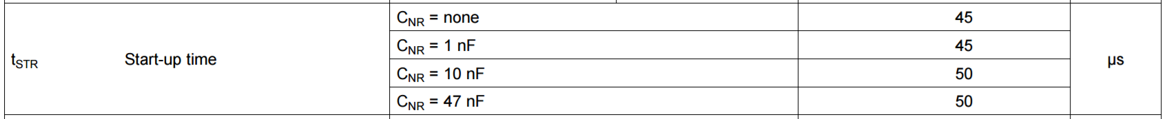

I'm planning to use the TPS735 in a new design, but noticed a discrepancy in the start up time values in the datasheet. The numerical values for startup time in the Electrical Characteristics (page 7) are 1000x less than the graph in the Application Curves (page 15. Actually, all of the graphs on this page say 10mS/div). I'm pretty sure the graph should say "10uS/div" and not milliseconds. Then the values would pretty much line up. Also, a 40+ millisecond start time seems unreasonable....
Application Curves (page 15)
