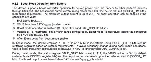

Hi Team,
Customer would like to try support OTG 2A.
Can you help provide a template for OTG 2A?
Or which registers we have to do the configuration?

Hi SHH,
If you follow steps 1-5 from the datasheet excerpt you included (OTG_CONFIG bit is REG03 bit 5) , you then need to set the boost current limit bits REG0A [0:2] to 110. You can also change the voltage regulation from the default of 4.998V to 4.55V - 5.51V in REG0A.
