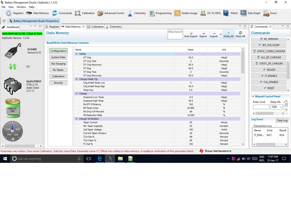

I have done some changes in gg file according to new battery and trying to import in Battery management studio, But it gives error as per attached screenshot.
Kindly support.
  • The CC Offset parameter must be outside the range allowed by the bqStudio setup . Try placing this bqz file in the config directory and reopen bqStudio. I lower the threshold allowed by the program.
    C:\ti\BatteryManagementStudio\config
    https://e2e.ti.com/cfs-file/__key/communityserver-discussions-components-files/196/4885.0100_5F00_0_5F00_16_2D00_bq34z100G1.bqz
