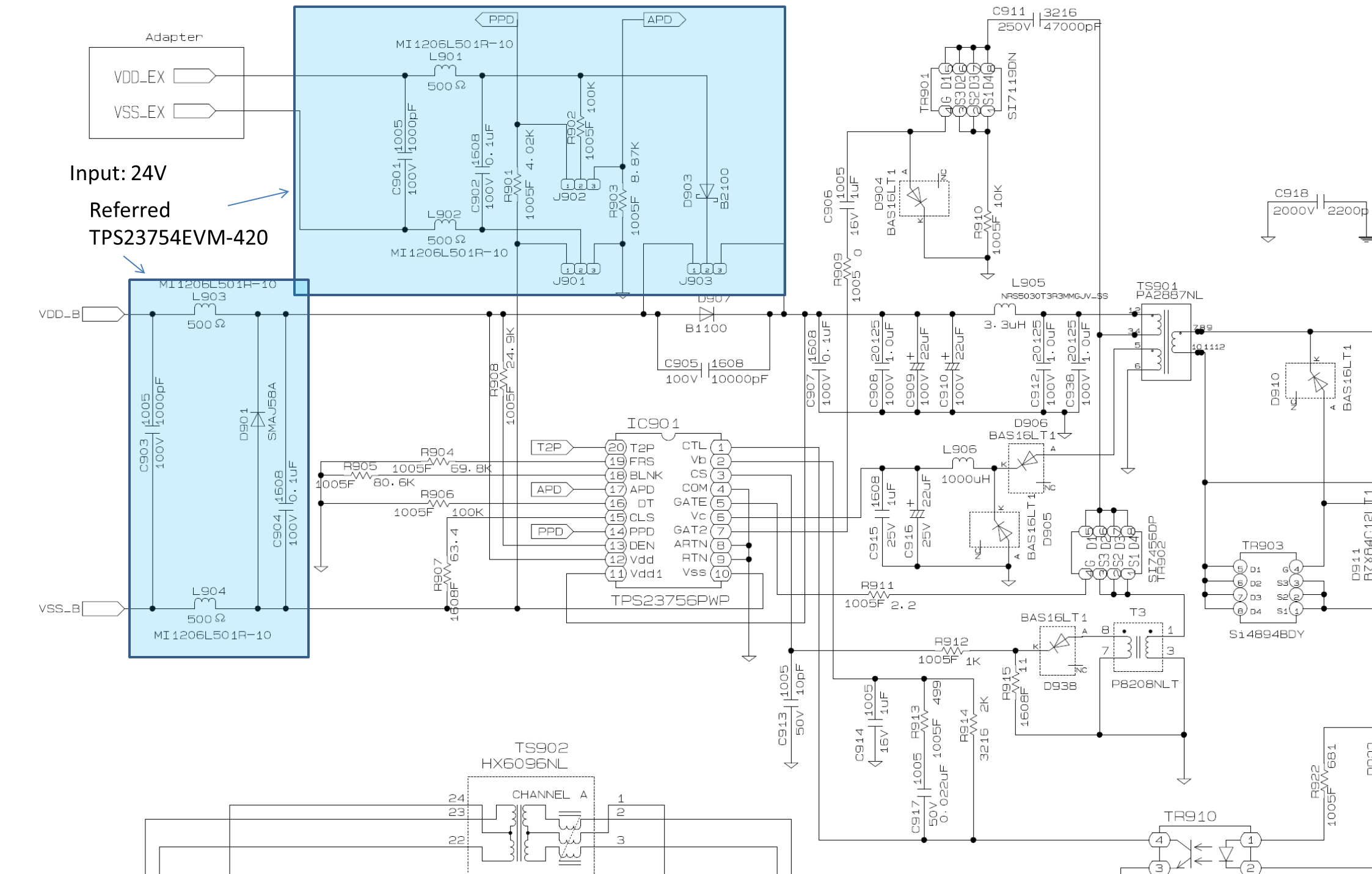

Hi
We are referring TPS23756EVM to achieve:
Topology : Forward
Input : 24V
Vout : 5V
Now we have to consider reducing the circuit size.
To support 24V input, we could refer the design of TPS23754EVM-420.
(TPS23754EVM-420 seems to be less parts around the input part than TPS23576EVM)
Could you check the following schematic?
The schematic is made with TPS23756EVM, except for the following blue boxes.
