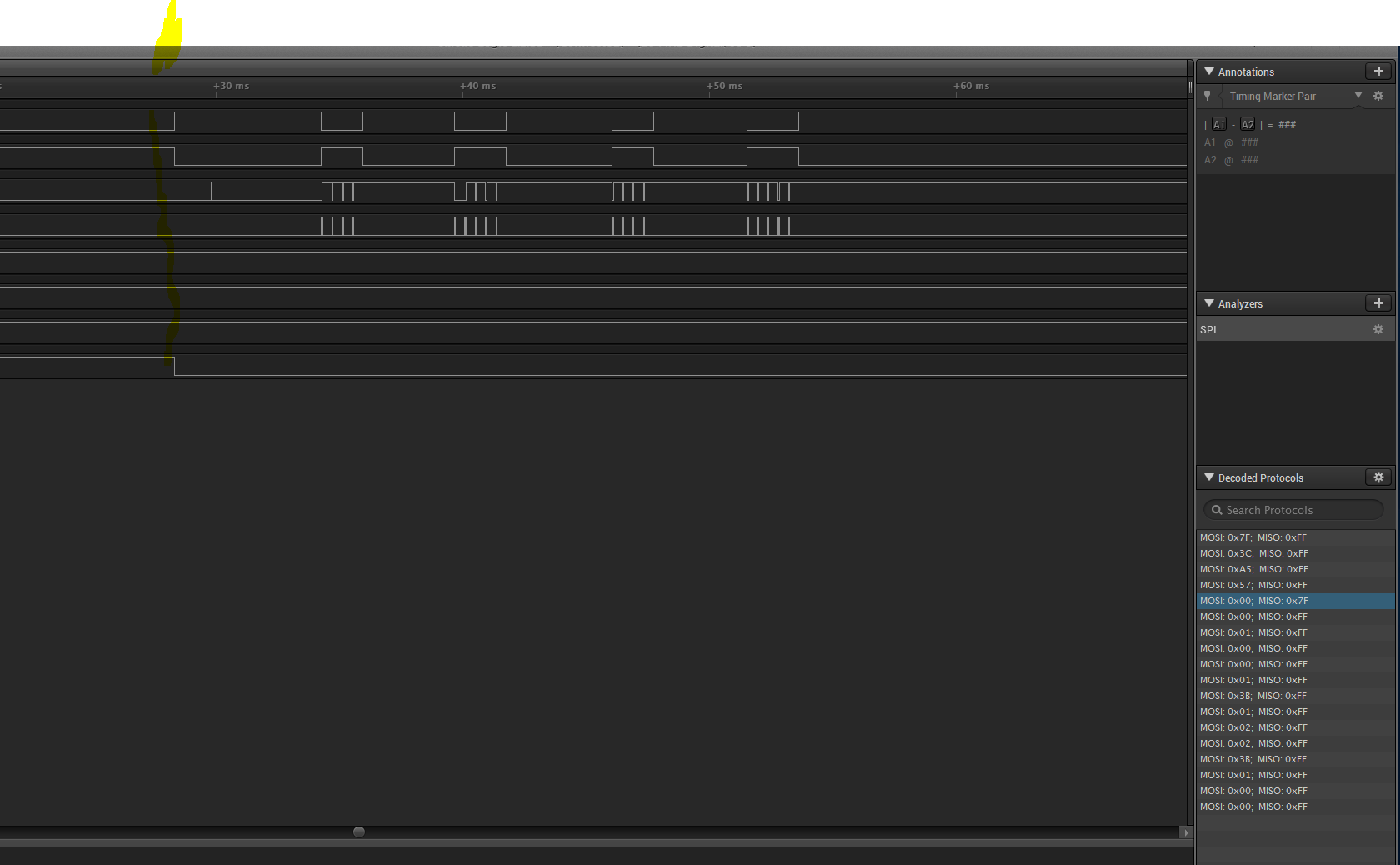

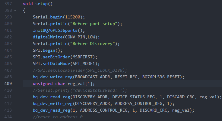

I ported the MSP430 code to Processing/Arduino and even tried sending the raw SPI commands and all the responses are 0XFF there is only one byte which I get a response 0x7F
Here is the code

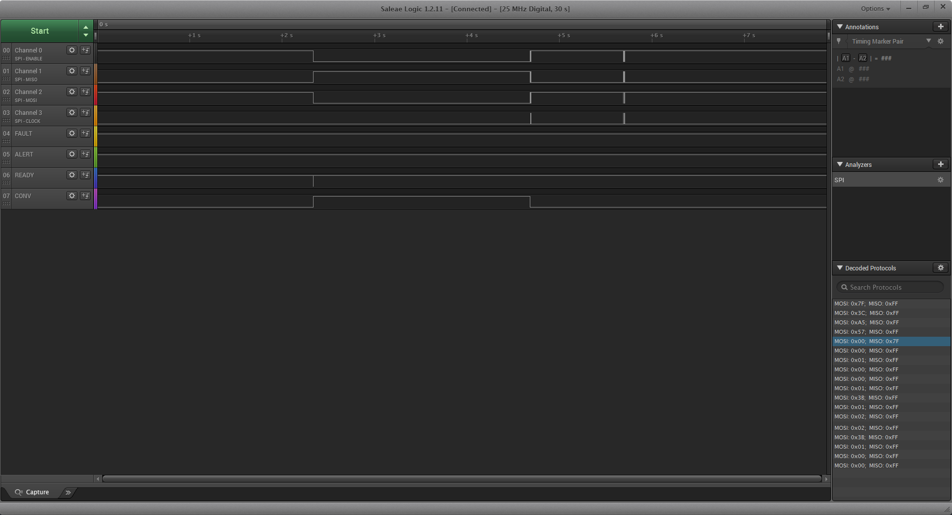

Here is  the SPI data between the Host and the BQ
Anybody have any idea what could be going on?
