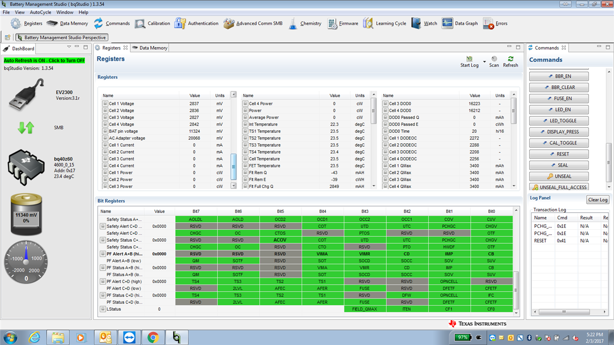

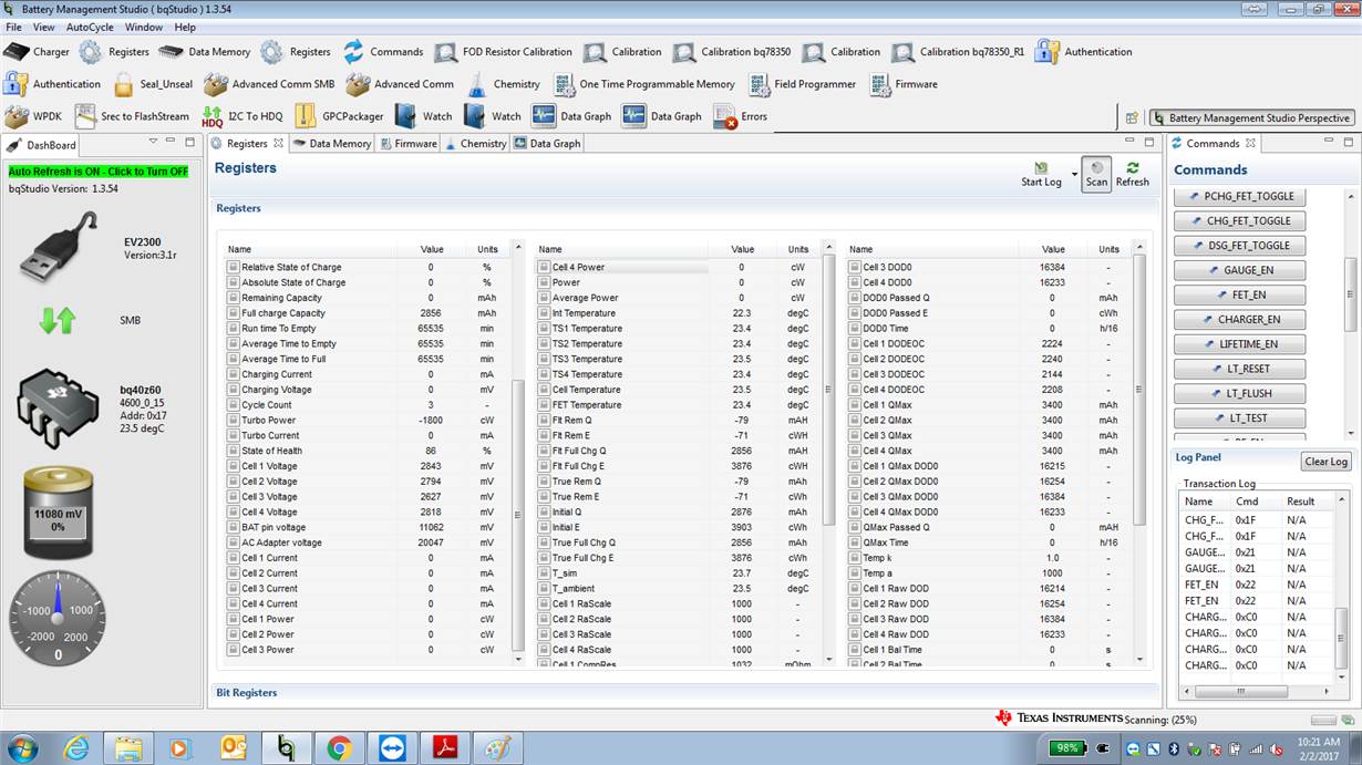

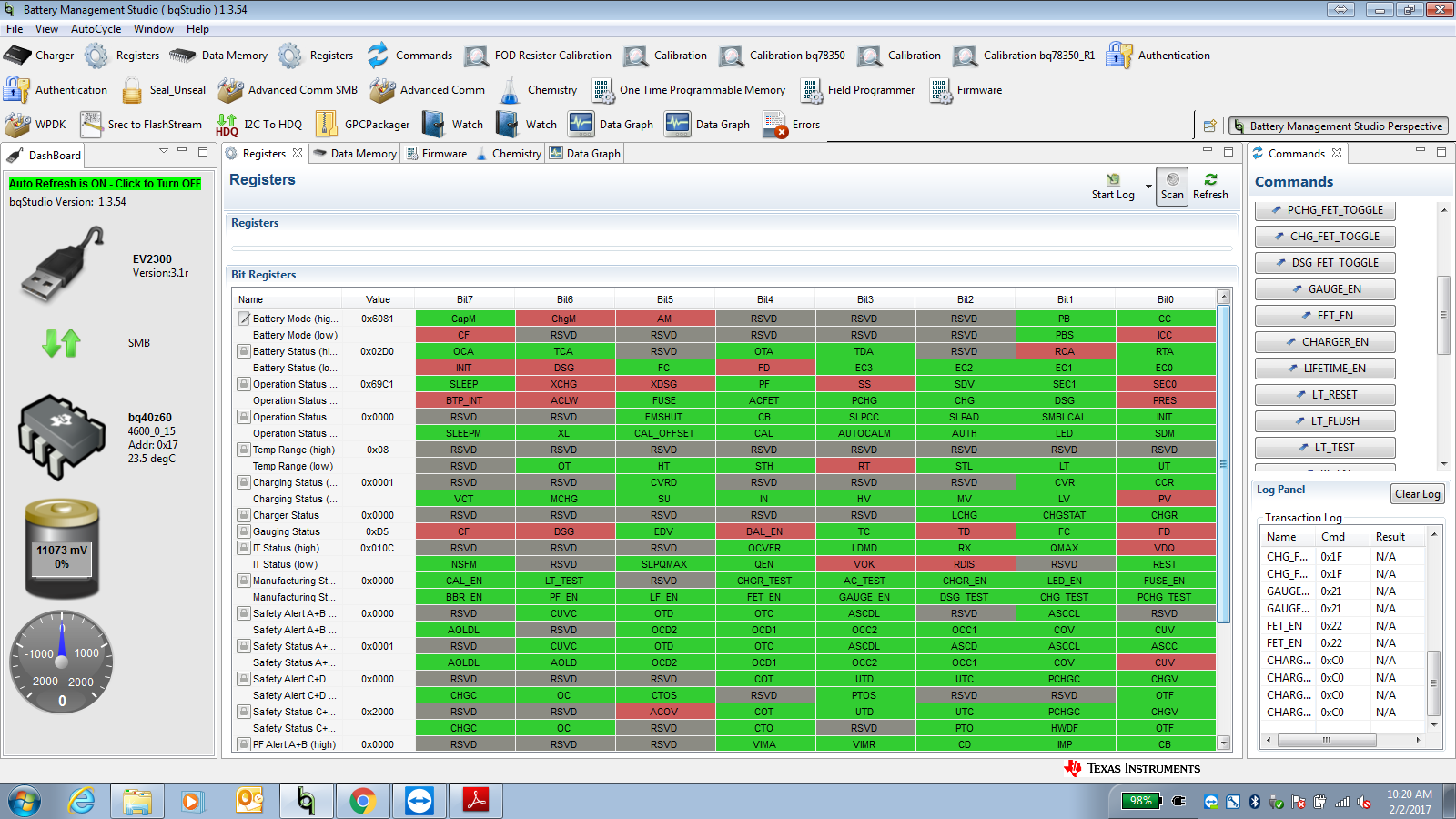

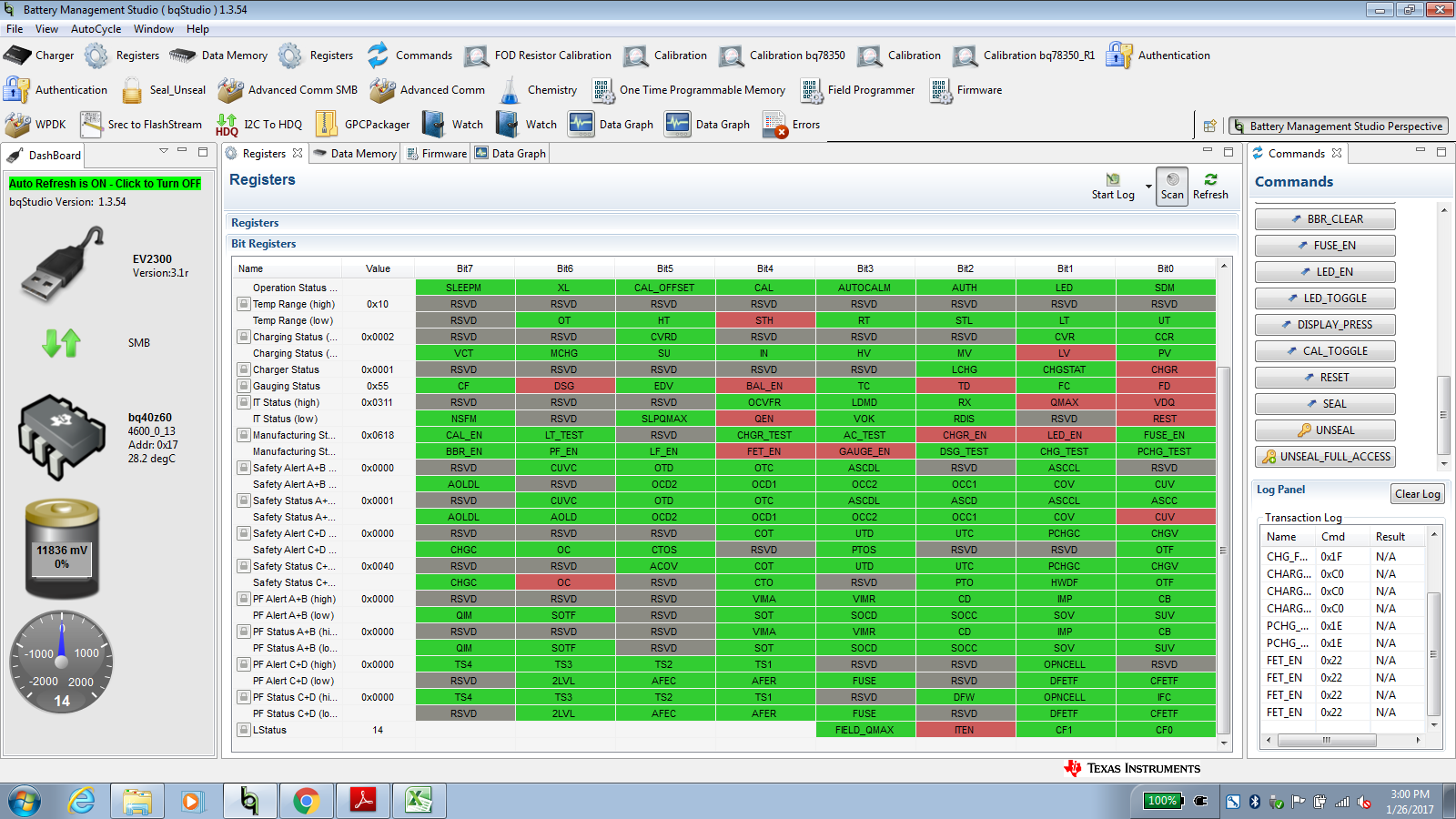

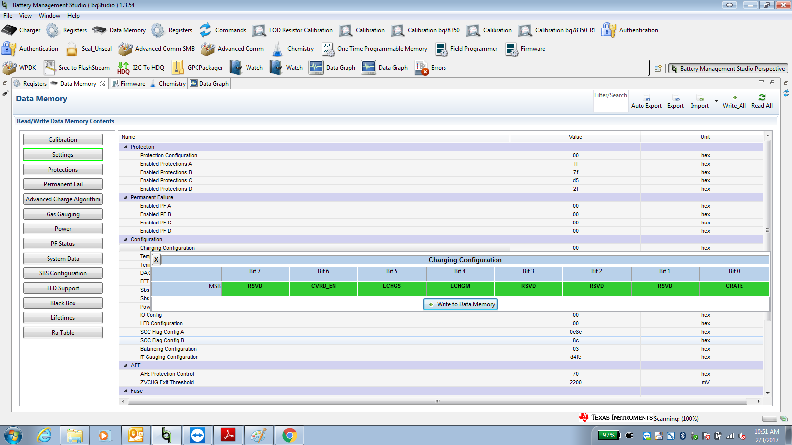

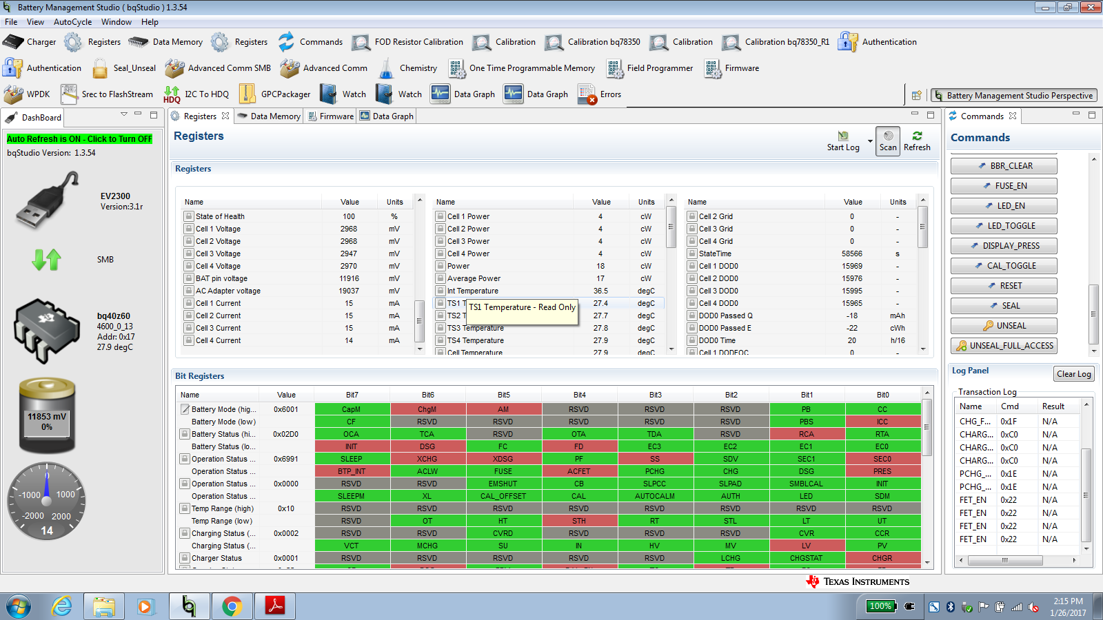

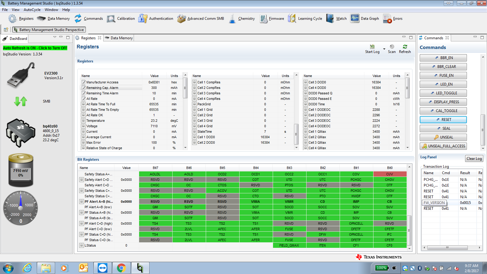

Hi Guys,
I'm using TI BQ40Z60EVM-578 evaluation board to charge our 4-cell Panasonic NCR18650B 3350mAh battery. The load is a 40ohm resistor load.
The first  two charing and discharging cycles look pretty. The battery will be fully charged and the stop charge voltage is 4200mV. Once it's discharged, the charger will stop at 3000 mV. Everything seems normal.
Until today, the fully discharged cell pack start to be charged. However, the precharging time took about 4 hrs with current to be around 15mA, which should be 250 mA by default. The precharging curernt is still 15mA after 4 hrs. could you figure out why?
Lian
