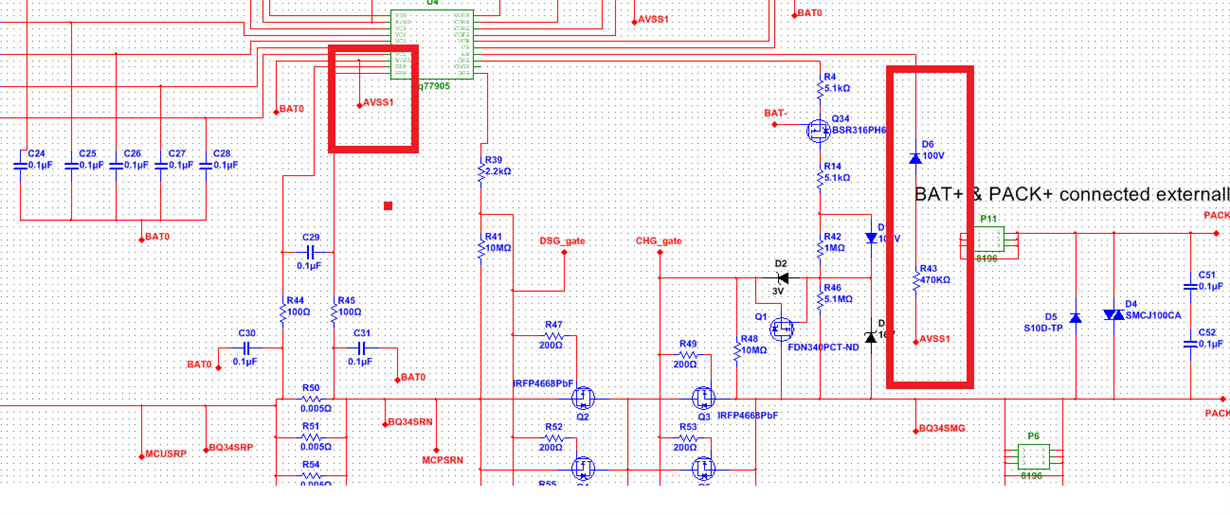

I have a EV application & using bq7790503 in it for over/under voltage, over/short current & over/under temperature protections. Most of its parameters suits my application but in current fault recovery method datasheet specifies "Load Removal + Delay".
But in my application I need only "Delay" method. Can I somehow bypass the "Load Removal" in it.
  • HI Deepak,
    You should be able to ground the RDL resistor and this way that won't create problems with load removal. The one caveat is that that means you will have immediate current recovery when the fault condition is removed.
  • Hi Miguel,
    You mean something like this.
    1.Also how about recovery from UV/OV./OT/UT. They are all hystersis based in bq7790503 right.
    2. In current fault recovery, now system will try to recover after 1 sec each. Right.
    Please confirm above two points?

  • Hi Deepak,
    1. Yes they are. Especially by grounding the LD pin, any recovery condition that will requires "load removal" will have been met automatically and only the delay or hysteresis needs to be met.
    The down side is that if you wanted only "delay" for recovery on OCD but "load removal + hysteresis" on UV, this is not possible. On the bq7790503, I believe the UV recovery is "load removal + hysteresis" . If LD is grounded this will just be a hysteresis based recovery as the load removal has been met.
    The LD pin can also be tied directly to ground, so there is no need for a diode. A resister doesn't hurt.
    2. Yes
    -MZ
