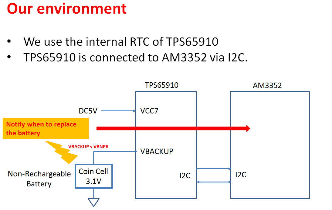

Hello, we use PMIC TPS65910 as the power supply forAM3352.
We also use the Coin cell for TPS65910(RTC) backup as the following diagram.
Could you please tell me how to inform VBACKUP < VBNPR status to AM3352?

  • Hi ay0689,
    What exactly are you trying achieve with alerting the processor? Would you like to notify the processor right after VBACKUP < VBNPR? Are you using the RTC of the TPS65910 or are you using the AM335x's RTC?
    Paul Kundmueller
  • Hello Kundmueller-san,
    => To know Replacement timing of the Coin Battery.
    => Yes. The processor will inform "REPLACE the Coin Battery to new one" on the LCD screen to the User.
    => Both.
    TPS65910 RTC Values are tranferred to AM335x's RTC after AM335x is powered up.
    PMIC RTC is always clocking while AM335x is in Power OFF state.
