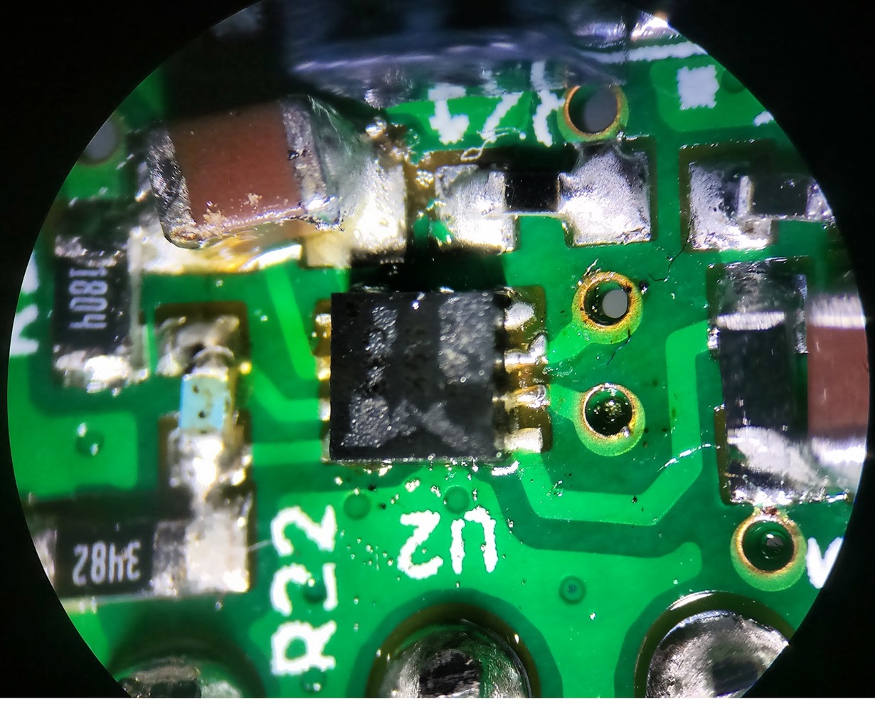

    I am not really sure what is the issue. The main problem is that I have 12V output on the PSU but  I don't observe any signal output at the output of TPS62125.
     The below picture is from one module that was working when I test them at office, but failed on the field. It looks like I did a hand assembly
    - As I experience from different cases, there should have been a physical damage on the case if there was an over voltage or current failure (none of the faulty modules have physical damage). CC2630 withdrawn very less current only about 7mA or less.
    - I have observed the PCB by a thermal camera, there is no heat issue.
    - I visually inspected all the modules if there is any short circuit, and then did continuity test by a DMM before powering the modules. There was no issue.
    Do you guess any possible issue based on your experience what might be wrong? Would you suggest to place any protection circuit before TPS62125?
    I am attaching the gerber files if it would be easier for you to see the layout (I can share eagle cad file as well).
    Could it be layout related issue? One issue that maybe I should not have placed the inductor to the bottom layer to save space, instead keep them all on the same layer. What do you think?

    Regarding the ESD, the modules are produced in ESD-controlled environment, however, when we placed the modules into the enclosures, we didn't wear grounding straps and I noticed some of the modules broke after it. I assumed they broke because of the ESD issue (and due to very small package).

  • Especially since some units didn't work after you put them in your system (and they were working before), I think ESD or handling damage is a likely culprit. You should not be handling these ESD-sensitive devices without grounding.
    If you frequently see failures at the first power on, you should look at Vin, Vout, and SW as you apply power to your system. There may be some overvoltage.
    Similar devices with leads are TPS62120 and TPS62160. Your new schematic is fine.
