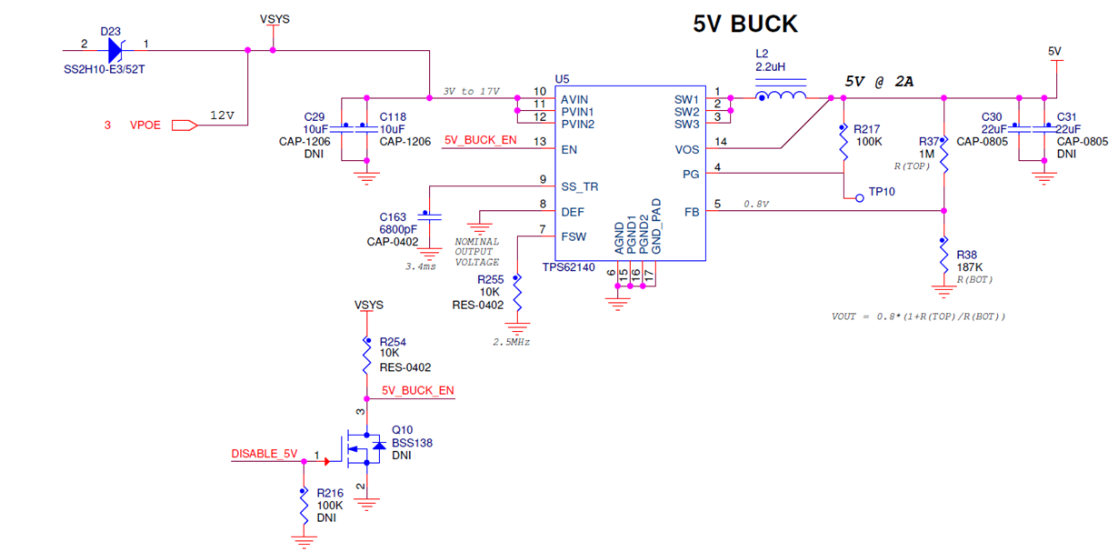

  •  Here is the Schematic.   Pretty straight forward.

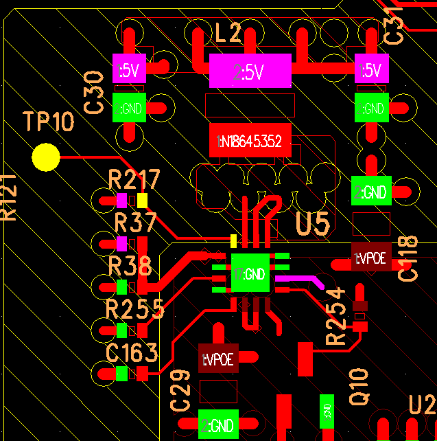

    LAYOUT
    After reviewing the layout I see a significant copper pour on the Switch node and for whatever reason C29 is not tied directly the PVIN pins.  Can that cause a device failure.
  • It's a little difficult to read the layout images (I can't see any vias for example) but it is clear that the input cap is not well placed/routed. Please see this app note for how to do a good PCB layout: www.ti.com/.../slyt614.pdf
    As well, you might look into using the TPS82130 module for an easier layout and overall simpler design.
  • I did see that the input cap was not tied directly and have already talked to the design engineer about this layout.
    We had already started modifying boards yesterday by manually placing 220nF || 220nF (used 2 caps to reduce parasitic inductance) directly to the input pin on 18 devices that had previously failed, a couple had failed twice even. 12 hours burn-in so far and no failures.
    I think the poor input cap placement is our issue. Great app note by the way, I've passed in on.
