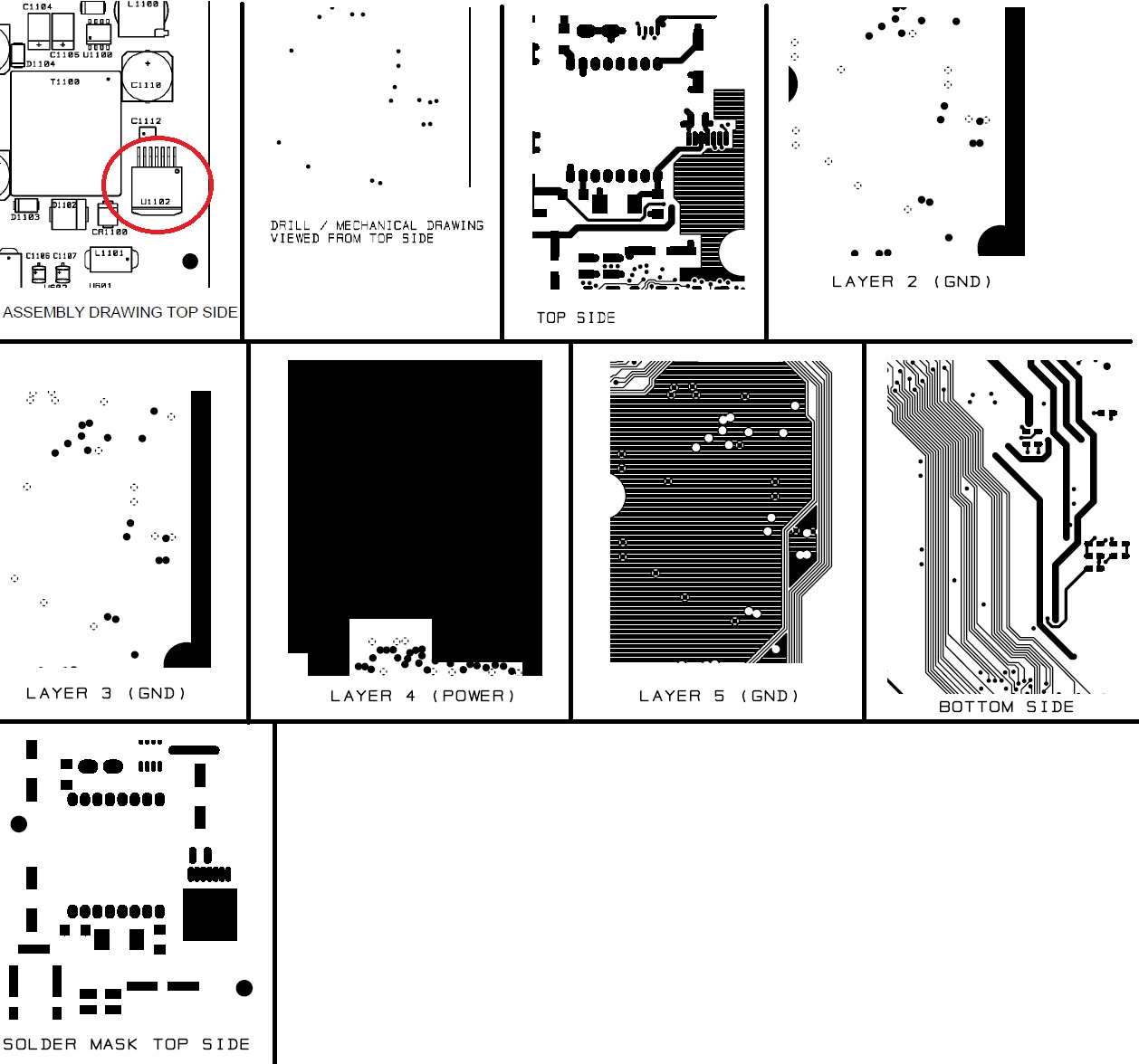

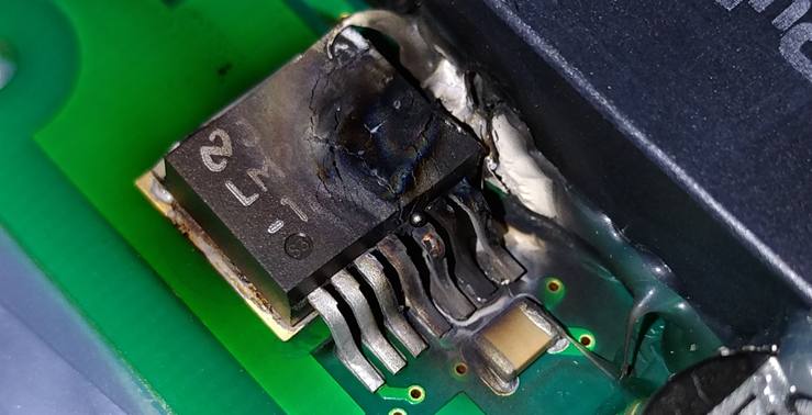

I have two boards that failed using the DC/DC switch regulator LM2586S-12 (input of 30VDC and output of 12V).  I'm facing the following scenario:
-LM2586 ICs were severely burned on both failures, mostly on area of pins 5,6 and 7 (as per attached pictures).
-Board's design did not consider the use of the Schottky Diode SA51A shown on Figure 57 of the TI "SNVS121D-MAY 1996-REVISED APRIL 2013" data sheet.
Could you please send me any information that could help us on our investigation?
