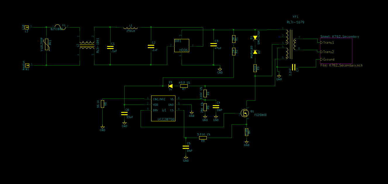

When trying to use the oscilloscope to view the waveforms, am I supposed to ground the oscilloscope probes? I do not have an AC power supply. I am using Mains Voltage 120VAC 60HZ. When I tried grounding the probe, the probe blew up. Why is this and how can this be fixed? Will using an AC power supply help? I have one ordered and on the way now.

  •   While I wait for my AC power source, I am trying to use differential probes to measure the waveforms. I have realized that I am only getting about 15 VDC on the VDD pin. Therefore the chip never reaches turn on voltage. I have seen this circuit work before and I am wondering what could be causing the low voltage now. I

    After the board was damaged, what components had to be replaced? It's worth checking if there are other damaged parts, in particular the UCC28700 IC, and the startup resistors R1, R2.
    Maybe it would be better to start testing on a fresh board?
    If you have a DC source available that can go to 100 V or so, you can test with that for now.
    When input voltage is applied (AC or DC), what voltage is at the top of C3?
    Can you see the VDD pin rising exponentially from 0 V towards the 21-V start level?

  • There are all new components on the board. I do not have a DC power source available. My DC power source recently broke. I have 170VDC at the top of C3. I was seeing the voltage rise (slowly) from 0 to 21 on the vdd pin and once it got to 21V it started jumping around. However, now it it is just jumping around 15V and never reaching 21V. I have been watching the training video and will try to continue looking at waveforms once my AC power source comes in the mail.
