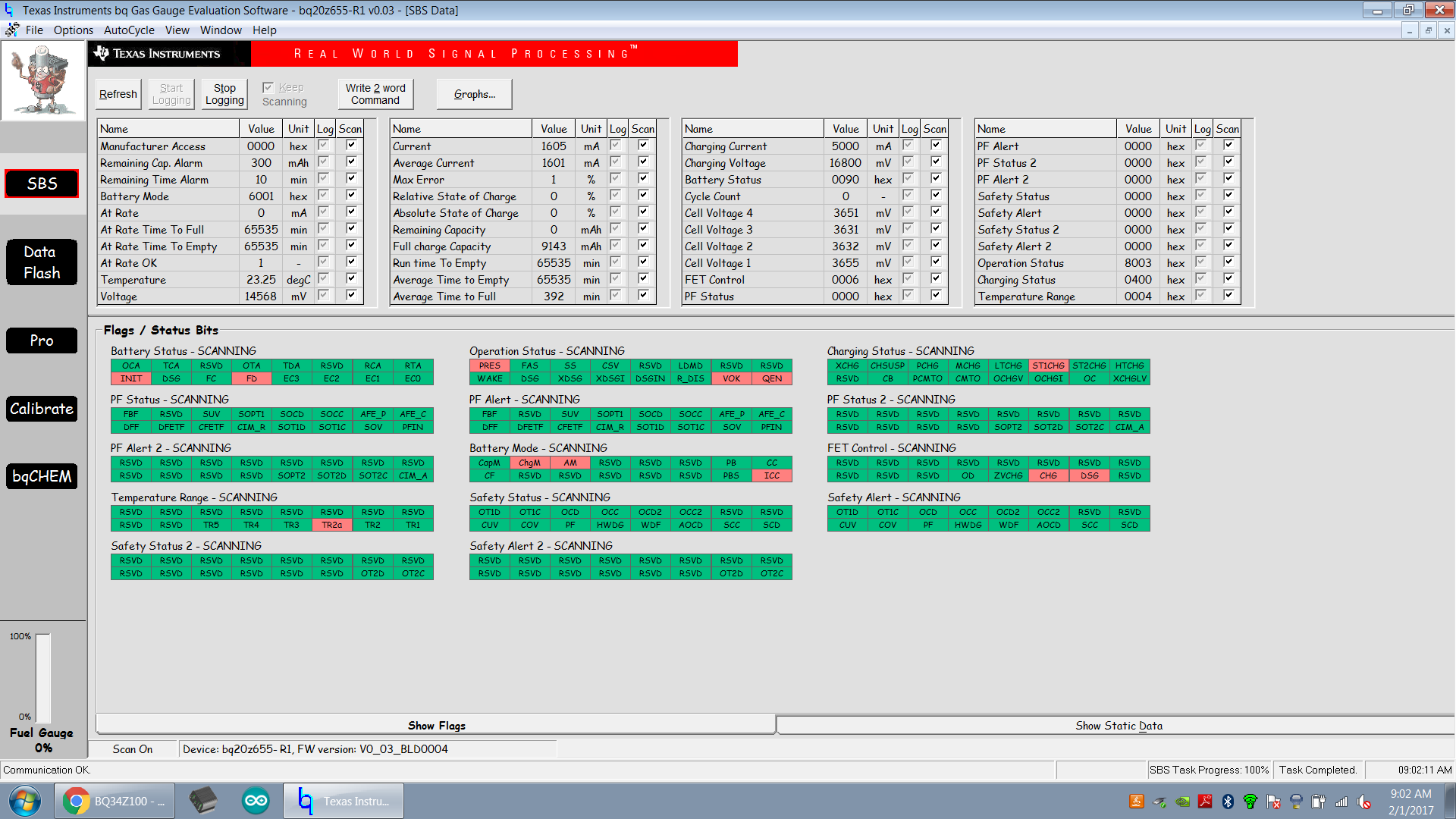

I created a golden unit following SLUA379E. I then discharged the unit down to cutoff.
During the next charge cycle, I noticed it was charging intermittently. I've included the log file showing the weirdness.

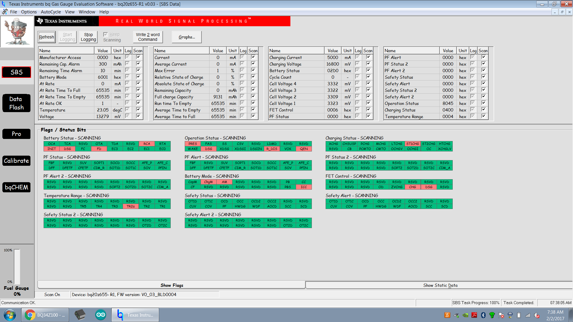

I decided to reprogram the pack with a fresh .senc and upload my .gg. I sent a reset (0x0041) but now I show no capacity.Golden_Data_Charge_Capacity Issue.zip
What is going on? Other possible pertinent info - right now I am using the default chemistry because I cannot get the Mathcad file to work...
