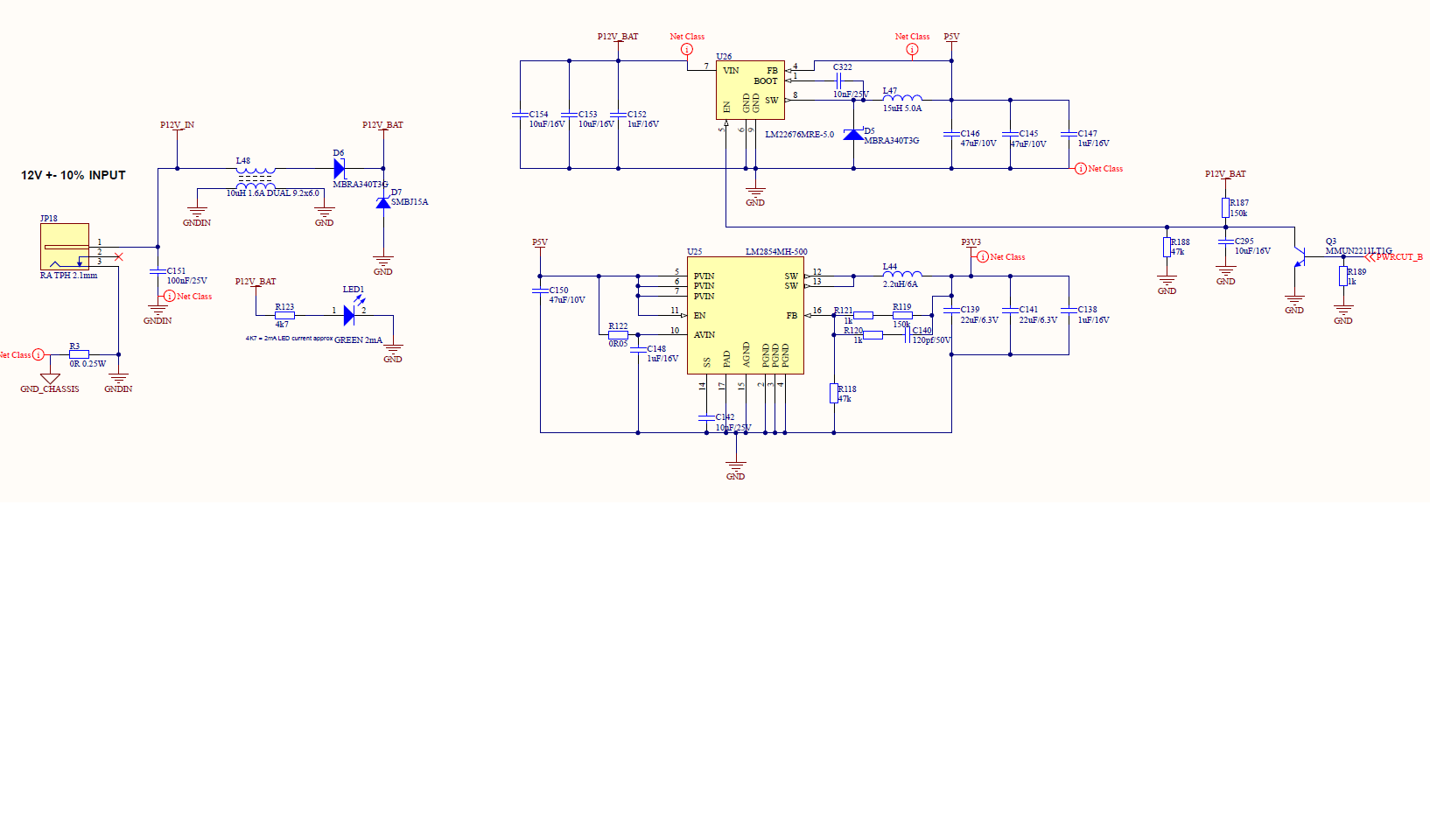

I have a legacy product  with a LM2854MH-500 used to produce 3.3V rail (2A to 3A output) from 5V input.  The 5V input is sourced from  a LM22676.See below.
This design has proved reliable in the field for 7-8 years.
Recently we have seen a number of the LM2854 fail with the output short circuit to GND (2 or 3 out of 20 shipments)
These installations differ in that they use a 13.6V float (on a 12V SLA Battery) as the 12V input.  Although that difference suggests it must be related  I can see no obvious reason for it to cause problems (and if it did I would expect the LM22676 to fail instead?)
Putting the component values into Webench seems to suggest the design is satisfactory (albeit not the component values Webench itself proposes)
Grateful for any ideas on this
