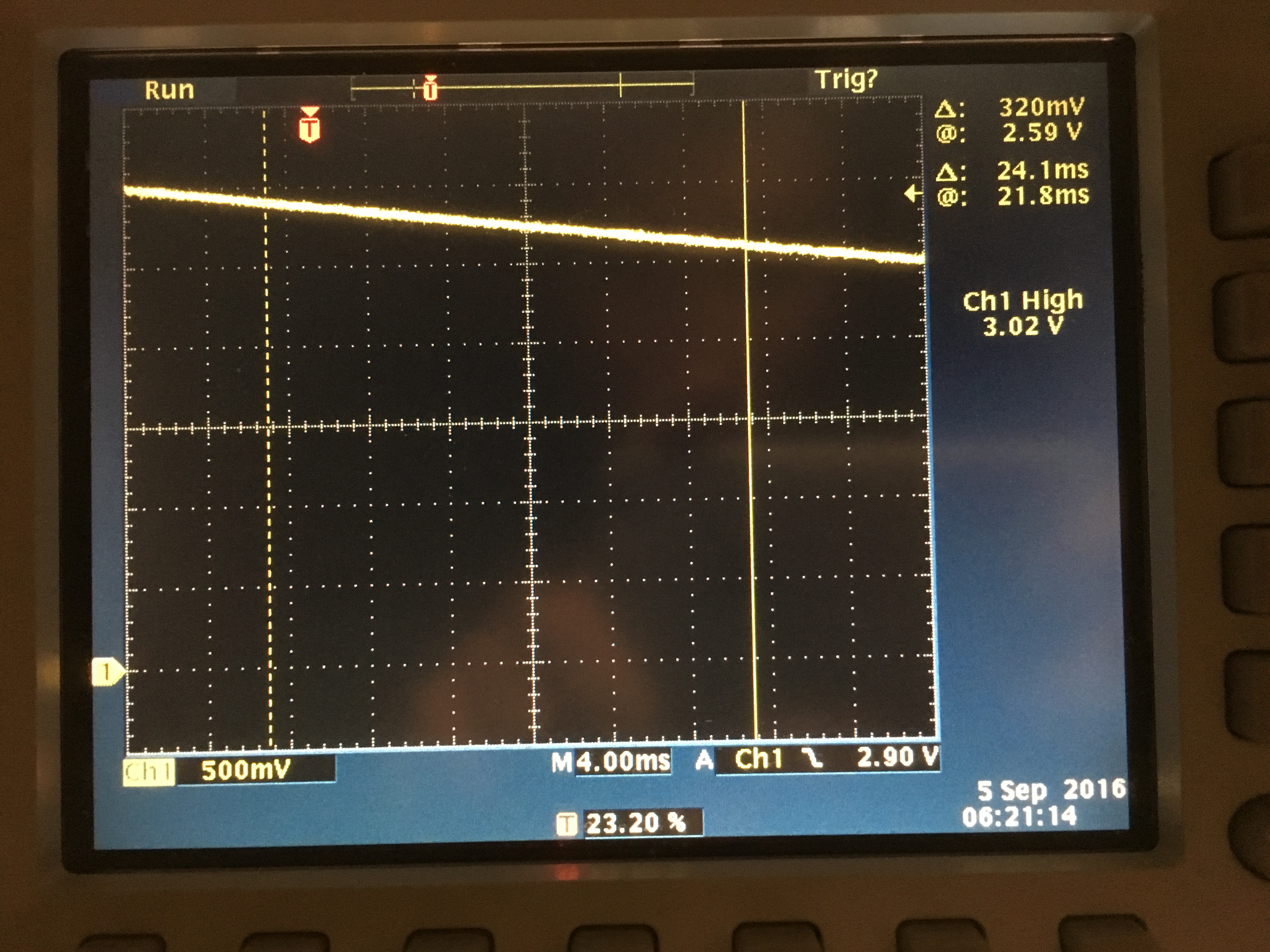

- I set MISC_CONFIG bit0=1 to enable the brownout function.  I see that I have more than 5ms from 2.9V to 2.6V per the spec (I measured 24ms on my board).  However I don’t see logged_faults being saved across UCD power cycles. Is there other configuration needed?

Here is a capture of V33A and V33D during power down:

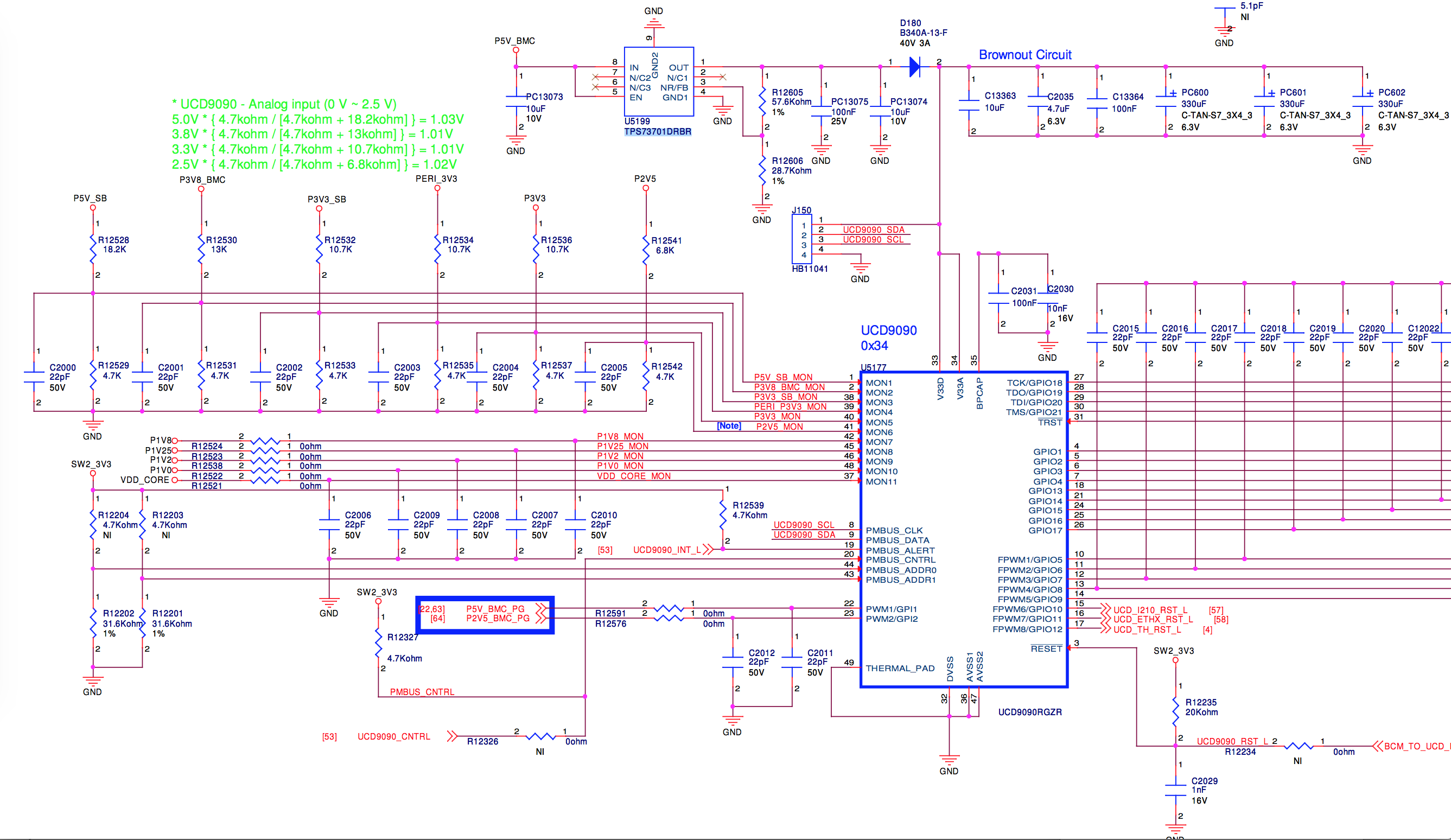

Here is our UCD schematic for reference:

    I found that the unexpected behavior was due to the UCD reset not being pulled to the brownout hold up circuit. After making the change everything works as expected. Thanks for all your help!
