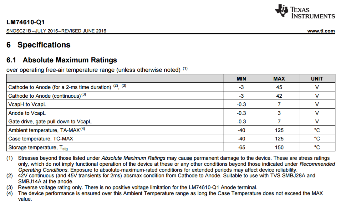

If remove TVS diode because customer avoid to use TVS diode,
How big voltage spike can LM74610-Q1+NMOS support?
in case of negative and positive spike
Thanks.
